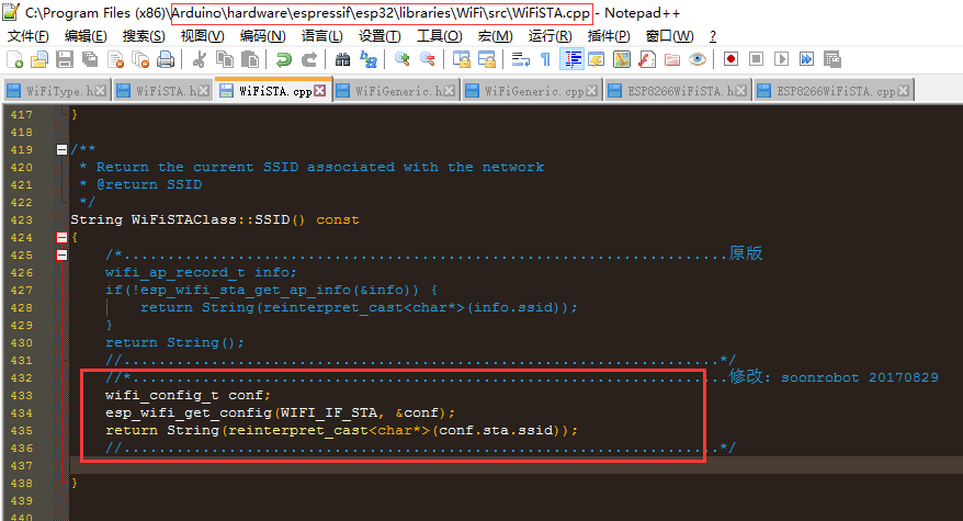

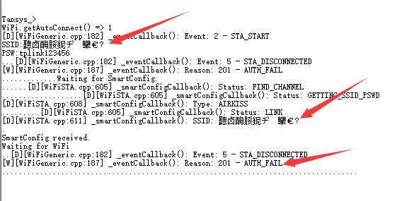

Description:
1.SSID returns empty,I have modified the“ WiFiSTA.cpp”。
2.Chinese character SSID garbled,Cannot connect network!
