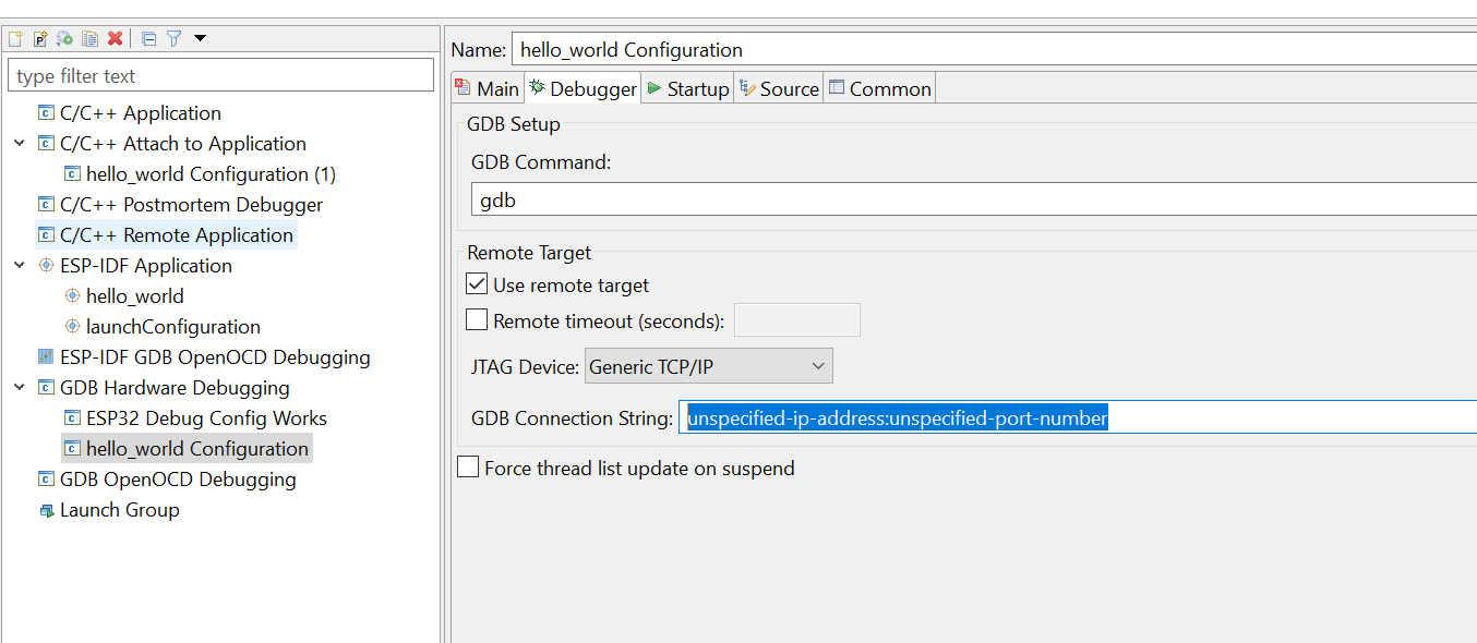

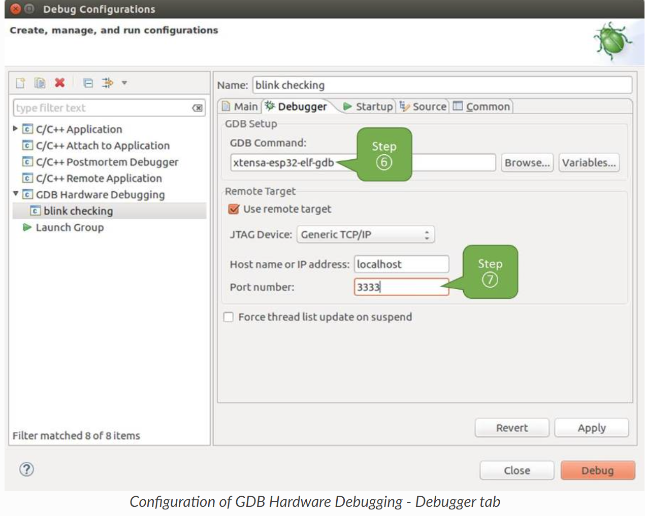

The problem I have is putting in the Debug Config as described here
https://docs.espressif.com/projects/esp ... ml#eclipse
Things have changed since the web page was done - you can see this is the web page instructions
It says to keep the hostname as localhost, and set port number to 3333, with Generic TCP/IP for JTag.
And this is what the IDE looks like now
The JTag Device I keep the same Generic TCP/IP, but there is this string for the connection
unspecified-ip-address:unspecified-port-number
What should the command be for the -target-select ? Is it correct - using the remote target option ? And then a colon : and port 3333 ? The default string in the field shows
GDB Connection String : unspecified-ip-address:unspecified-port-number
Do I just change it to
unspecified-ip-address:3333
Or
:3333
As neither seem to work. When I run Debug a dialog pops up and says
esp32 esspressif ide Failed to execute MI command: -target-select remote :3333
Any help appreciated. Thanks.
