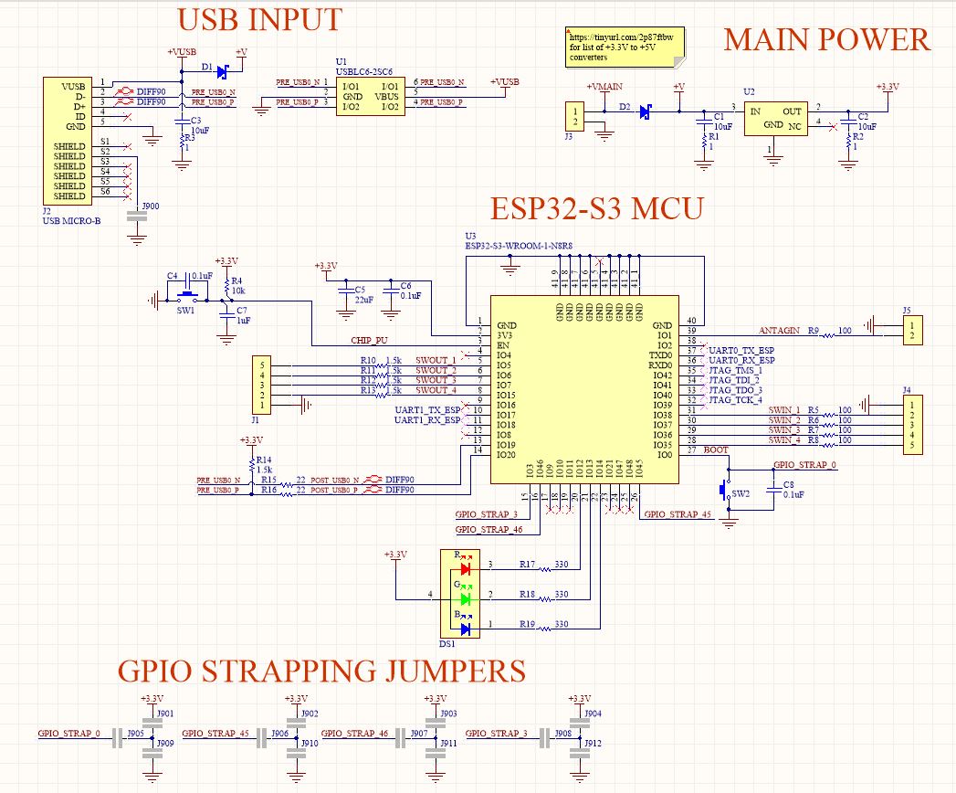

Hello. I have been using the ESP32-S3-DEVKITC fora bit now and it works great on either USB port (serial or native). I went ahead and decided to move to a custom PCB proto. Though the flash monitor process does not appear to be the same. Usually I am able to see the log messages right away after flashing but instead I get a different kind of output. When I press ctrl + ] to leave, my ESP32-S3 doesn't behave as it should (like to run the program). Am I missing something in the flash process now that I have moved to my own PCB? I have my schematic attached as well for reference.

First of all, you don't need or want R14; the ESP32S3 already has that resistor built in. Secondly, did you reset the chip with GPIO0 low? If so, the USB peripheral can't get you out of that state; you'll need to reset the chip with GPIO0 high.
I should have labeled R14 as "NOT POPULATED". That was placed there in case I ad just to adjust the pullup value for some reason. It is unpopulated on my board.
I reconstructed Figure 7 (page 25) on the module's datasheet. I left pullup to pulldown options for myself via solderable jumpers. My intention was to keep them unsoldered and see how to it went with just using SW2 on my board (pushbutton to ground).
To answer your question, yes it appears I did reset with GPIO0 low! There was a solder jumper that was accidently soldered after I reflowed it. I am going to fix it and try again tonight.

In normal situations, the USB-serial-JTAG adapter should be able to take you from a running program back into download mode and back to a running program all on its own. There's a few situations where it cannot (for instance, if your software accidentally reconfigures the pins used for USB) and in those cases you may need to force download mode using GPIO0.
And yes, if you leave GPIO0 floating, you should get the devkit behaviour.

Okay great! I have left GPIO0 floating and it worked great on the first try. However, it does still get stuck on the "waiting for download". But with a quick flick of the reset button, the main app starts great. But when I try to flash again, it doesn't wanna take. After some fiddling, I actually need to quickly hold both reset and boot0, let go of reset, issue flash-monitor command, and then it will take. I see the value of that auto program circuit now in the devkitC. I noticed that it interfaces with the USB-UART bridge. Is there a similar auto-program circuit for when one uses the USB-serial-JTAG adapter port? Or is it the same? And if its the same, not sure where RTS and DTR go. Been a while since digital electronics class but the auto program circuits looks like an SR latch?

You should not need a DTR/RTS/whatever circuit with the internal USB-JTAG-serial adapter. However, I think C8 in this case is the culprit: on bootup the cap is empty and will pull down GPIO0 to ground, meaning the chip will start in download mode. Remove that cap and you'll probably have normal behaviour. In case you still want the functionality the cap offers, instead connect it between GPIO0 and +3.3V.
I did try that but it is the same behavior. Not sure why GPIO0 would be pulled to ground if there is an internal pullup for GPIO0. Nevertheless, I have a working custom PCB with the ESP32-S3 now and a working method (albeit wacky) to flash new code on the chip. Will just push me to get the BLE OTA working soon.
