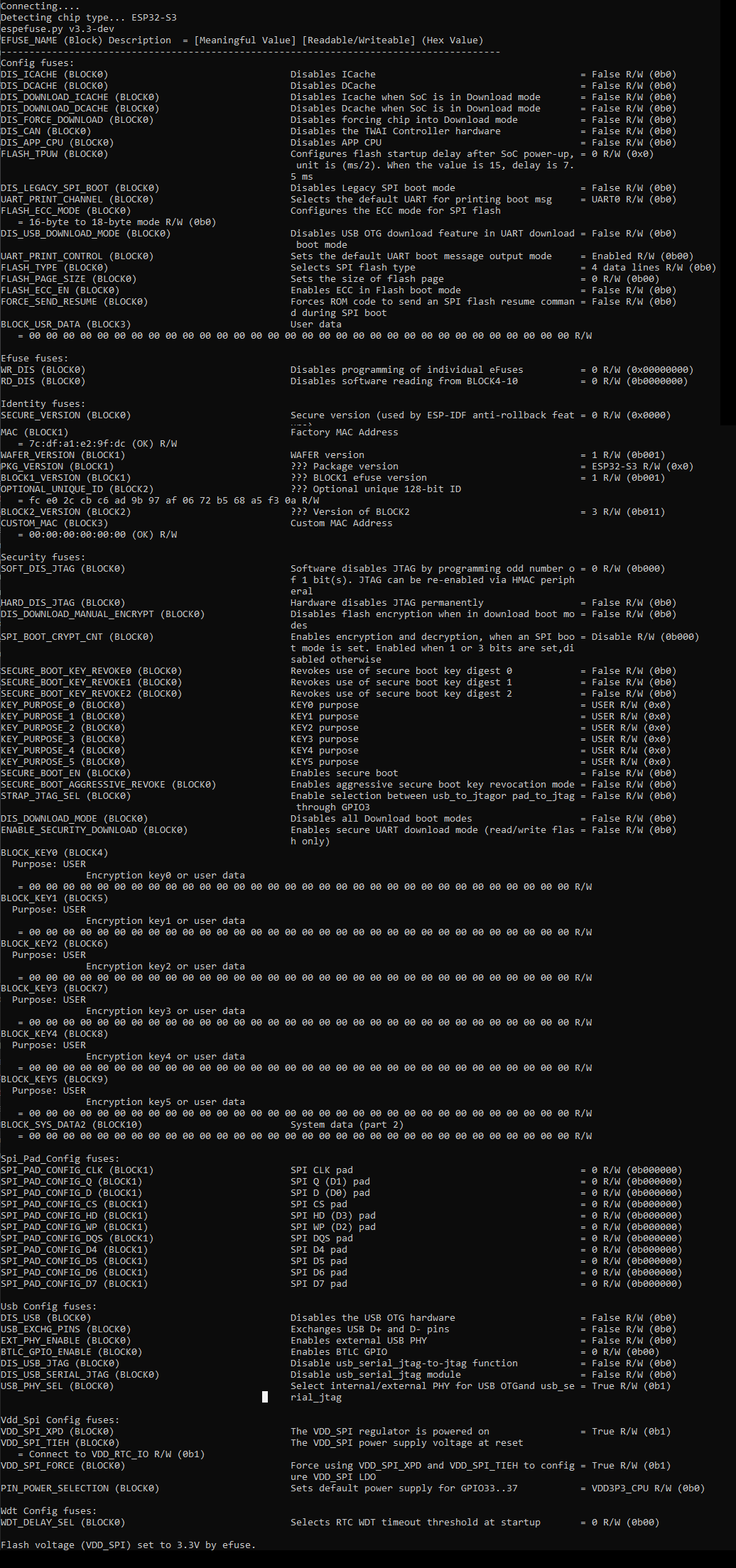

An external pullup is not needed and adding one does not lead to progress here, as simply putting the resistor on the D+ without the ESP32S3 connected would lead to the same result. What fuses did you try to burn exactly? Can you give an output of espefuse.py?

I burned the USB_PHY_SEL fuse per the instructions on this page:
https://docs.espressif.com/projects/esp ... s/dfu.html
Ok output attached.

Postby ESP_Sprite » Mon Mar 21, 2022 2:07 am
That indeed seems correct. One more thing: are you checking the DFU mode specifically when in download mode (IO0 low when chip is reset)? The existence of DFU when the chip is running depends on the user code programmed into flash, but DFU should always be available in download mode.
