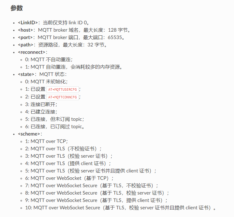

fst202130609
Posts: 171
Joined: Thu Sep 23, 2021 10:03 am
Re: esp-at使用at指令来连接阿里云失败
Postby fst202130609 » Wed Mar 02, 2022 3:19 am
我设置了client ID,用户名,密码,为啥我用AT+MQTTCONN?指令还是:+MQTTCONN:0,2,1,"","","",0
ESP_Sun
Posts: 326
Postby ESP_Sun » Wed Mar 02, 2022 3:42 am
AT+MQTTCONN? 查询到的结果是正确的,AT+MQTTCONN 文档:https://docs.espressif.com/projects/esp ... qtt-broker,对于连接不上的问题可以抓包看下

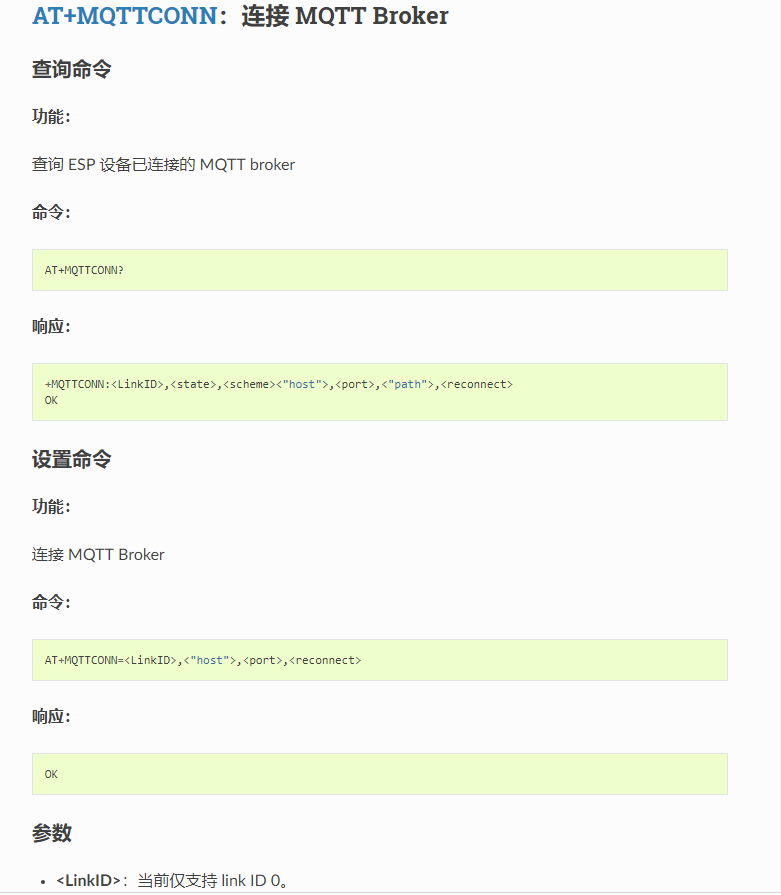

fst202130609
Posts: 171
Postby fst202130609 » Wed Mar 02, 2022 3:47 am
AT+MQTTCONN?命令不是查询是否连接mqtt-broker吗?那我设置了用户名,clientid,密码,结果返回:+MQTTCONN:0,2,1,"","","",0
怎么抓包?
ESP_Sun
Posts: 326
Postby ESP_Sun » Wed Mar 02, 2022 3:51 am
AT+MQTTCONN? 是查不到 name,id,password 的

fst202130609
Posts: 171
Postby fst202130609 » Wed Mar 02, 2022 4:01 am
ESP_Sun wrote:
Wed Mar 02, 2022 3:53 am
您可以看一下这个文档 https://docs.espressif.com/projects/esp ... guide.html 来抓包。
我mqtt已经初始化了,那我用这个AT+MQTTCONN=0,"a1iLwGnfcuL.iot-as-mqtt.cn-shanghai.aliyuncs.com",1883,1,为啥返回失败,我是在Windows里编译esp-idf的,没用Linux环境
