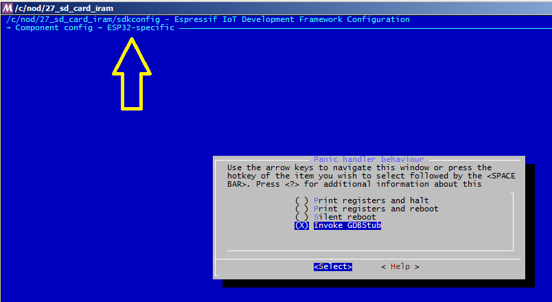

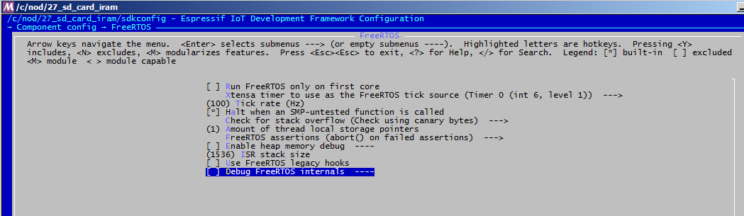

hi
where is the 'Component config -> FreeRTOS -> Panic handler behaviour -> Invoke GDBStub' option gone in menuconfig?
Posts: 1731
Re: [Solved] Recipes for debugging exceptions ...
Postby rudi ;-) » Sat Feb 18, 2017 3:35 pm
was moved to ESP32-specific

hi
Could please tell me how to insert a picture in a comment?怎么在评论里面插入图片啊?
Posts: 1731
Re: Recipes for debugging exceptions ...
Postby rudi ;-) » Tue Feb 28, 2017 11:33 am
roctwo wrote: Could please tell me how to insert a picture in a comment?怎么在评论里面插入图片啊?
here comes step 1 ( placed inline )
here comes step 2 ( placed inline )
step 2.png (9.8 KiB) Viewed 75094 times
hope this helps
btw: you can insert a link to a picture to, see the format design
B i u Quote Code List List= [*] Img URL Normal Font colour
