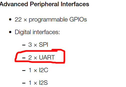

From the C3 datasheet, it has only 1 uart? In that case what should i do.

Where do you read that? Directly from the C3 datasheet:

Yes i can read that too, but i dont see the pins. Can you please tell me where are the 2nd uart pins are defined because i literally cant find them. Thanks.

TWO Uarts ... and their RxTx nearly anywhere
on my last -C3 boards I found Uart0 on GPIO20 and GPIO21 pins (routed to CH340 chip)
I choosed 18 and 19 for Uart1. just beside ..... ;-)
ESP_Sprite
Posts: 9769
Re: Esp32C3 BarcodeScanner Serial blocking
Postby ESP_Sprite » Thu Jan 06, 2022 10:30 am
Yep. The ESP32C3, like most ESP32-series chips has a GPIO matrix, meaning you can switch the signals of most peripherals (I2C, I2S, UART, SPI, CAN, ...) to any GPIO you want (that is not otherwise occupied). I think Arduino by default assigns two GPIOs (don't know which) to it, but you should also be able to manually assign them using something like Seria1l.begin(19200, SERIAL_8N1, tx_gpio_num, rx_gpio_num);,
