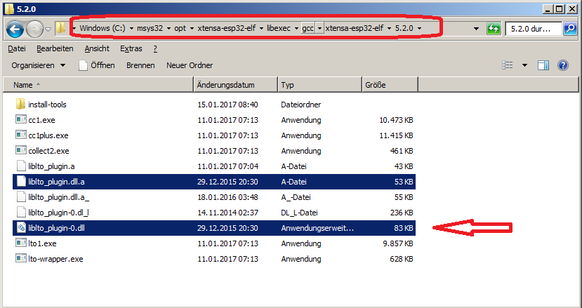

编译时提示如下内容
C:\msys32\opt\xtensa-esp32-elf\bin\xtensa-esp32-elf-gcc-ar.exe: Cannot find plugin 'liblto_plugin-0.dll'

www220 wrote:编译时提示如下内容

missings_5.2.0.7z
非正式地
windows 7 - 32/64bit try it
(34.79 KiB) Downloaded 772 times

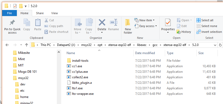

I'm having the same problem. I downloaded the https://dl.espressif.com/dl/esp32_win32 ... 170330.zip yesterday and it appears the directory J:\msys32\opt\xtensa-esp32-elf\lib\gcc\xtensa-esp32-elf\5.2.0 doesn't have the same contents as indicated by the previous post. Please see the screen shot. How do I/we get the correct contents?
Thanks
Tom

tjmesp32 wrote:I'm having the same problem. I downloaded the https://dl.espressif.com/dl/esp32_win32 ... 170330.zip yesterday and it appears the directory J:\msys32\opt\xtensa-esp32-elf\lib\gcc\xtensa-esp32-elf\5.2.0 doesn't have the same contents as indicated by the previous post. Please see the screen shot. How do I/we get the correct contents?
Thanks
Tom
hi tom
the problem is, that there is missing: liblto_plugin-0.dll
see here too
to solve the problem there are more possibles:
- we get an officially patch that fill the missing file in the folder
- we help us unofficially in the meantime with this try: ( not sure you saw the linked file in prev posting from me )
-- > download the attached file and unzip the missing file ( and a archive file ) to your folder
or
-- > download mingw and copy the missing file
--- example ( it is depended from your installed mingw // GCC version > 5.2 : you must search where the file is - usually here )
--- mingw/libexec/gcc/mingw32/5.2/liblto_plugin-0.dll
--- to your folder
hope this helps

Thanks - I used the file you offered and it appears compilation all worked
Thanks again for the speedy reply
Tom
