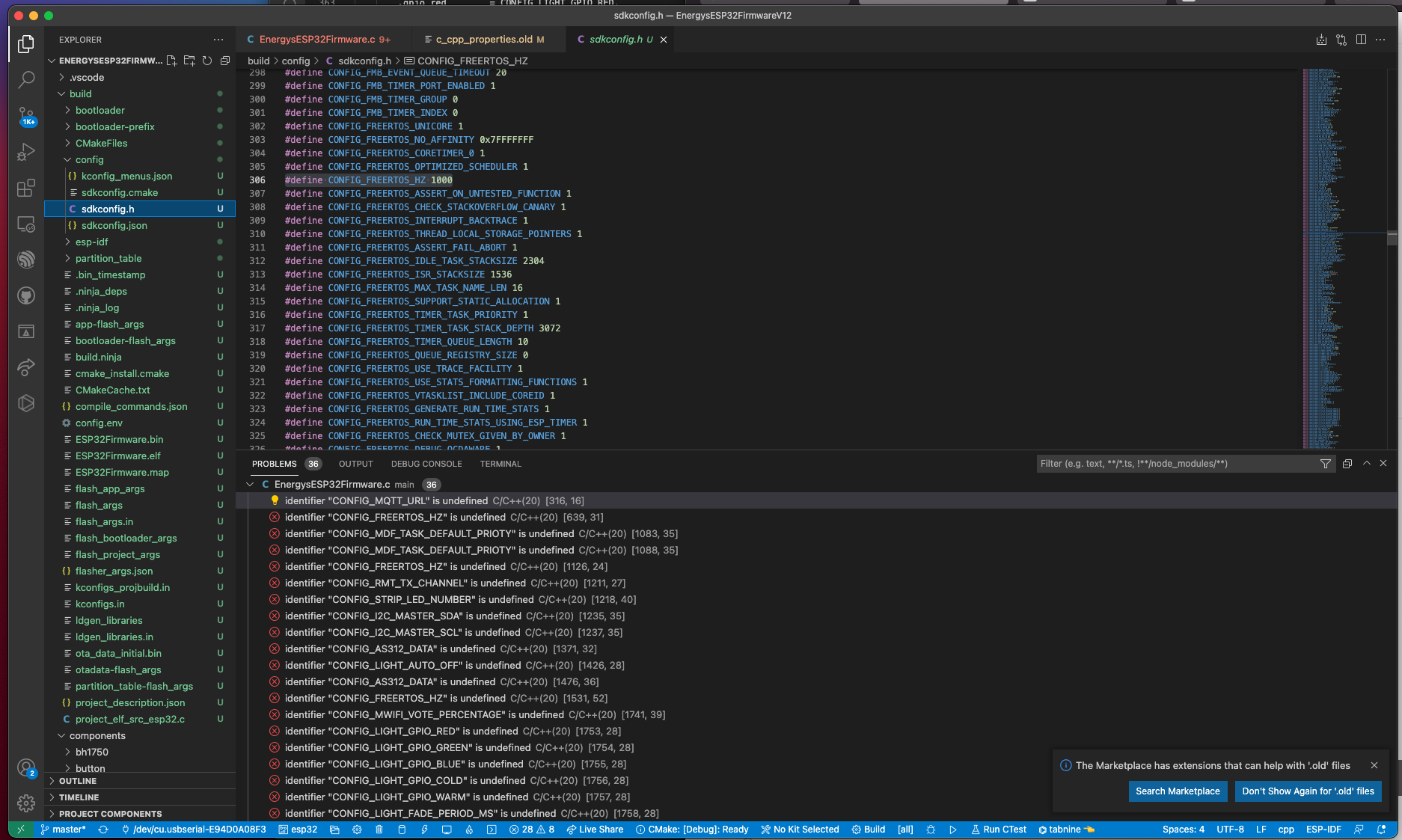

Hi. I am using VScode and always found that the IDE seem cannot detect the sdkconfig.h setting before or after the build.
I have done a idf.py full clean and idf.py menuconfig and save, but the error seem still here. The weird part is I can still build normally. Any solution for this???
Screenshot 2021-10-22 at 9.38.54 AM.png (593.52 KiB) Viewed 18365 times

Add "${workspaceFolder}/build/config" to your includePath in c_cpp_properties.json
Also helps to include sdkconfig.h directly in files where CONFIG_ values are used.

Some suggestions:
Add compileCommands: https://github.com/espressif/vscode-esp ... mmandsjson
Move the build/config entry to first in the includePath list
Improve other settings: cStandard to "c11", cppStandard to "c++17", intellisenseMode to "gcc-x86"
Ensure the Intellisense configuration is selected ("C/C++: Select a Configuration..."). I would expect to see the name, "MACOS", somewhere along the status bar.
Reset Intellisense database, restart VS Code, rescan workspace.

This one seem work now. Thanks
