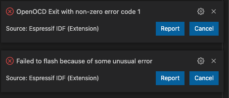

Hi, I am using MACOS, VScode and ESP-Prog with ESP32.
I found that the On-Chip Debugger always have the following error message
Open On-Chip Debugger  v0.10.0-esp32-20210401 (2021-04-01-15:46)
Licensed under GNU GPL v2
For bug reports, read
debug_level: 2
❌ embedded:startup.tcl:26: Error: Can't find interface/ftdi/esp32_devkitjv1.cfg
in procedure 'script'
at file "embedded:startup.tcl", line 26
[Stopped] : OpenOCD Server
OpenOCD Exit with non-zero error code 1
Is this error because of the openOCD cannot communicate with the serial port?

I found that there have some Debug adapter error message. Why those message appear?

Where are you executing openocd, in a separate terminal?
What happens if you just run
openocd -f board/esp32-wrover-kit-3.3v.cfg

XiotSamuel wrote:
Wed Oct 13, 2021 3:47 am
debug_level: 2
There is a mistake in the interface name, that's why it's cannot be found. It should be esp32_devkitj_v1.cfg instead of esp32_devkitv1.cfg. The reason, why it's wrong is a mistake in the esp-config.json file, which is located in .espressif\tools\openocd-esp32\v0.10.0-esp32-20210401\openocd-esp32\share\openocd\scripts. So you can edit this file and change "interface/ftdi/esp32_devkitjv1.cfg" to "interface/ftdi/esp32_devkitj_v1.cfg", or you can just update openOCD to the newer version, where this typo has been fixed
