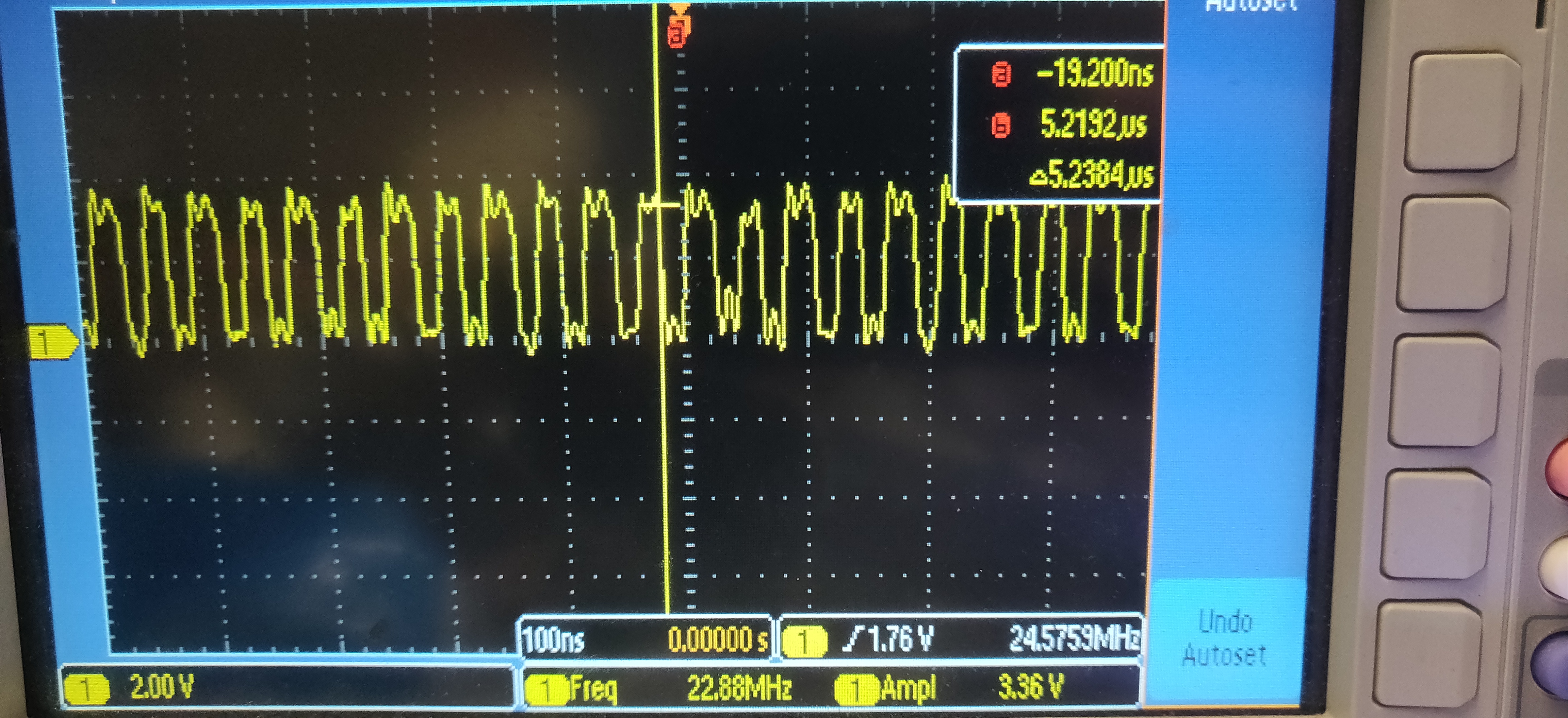

I have an external ADC connected to ESP32 devkit 4. I am using the I2S interface to read left/right channel data from external ADC.
Here, I2S in ESP32 will act as master and in RX mode. So, ESP32 will generate a master clock for synchronization. My sampling frequency is 96000.
I am using GPIO0 to generate the master clock. When I checked with IDF v4.3 it was clean and perfect.
However, I am going to use the ESP32-S3 module moving further, I have updated ESP-IDF to the master branch(v4.4).
I run the latest ESP-IDF master branch code in the ESP32 chip and checked the master clock on GPIO0 to validate clock signal, It is not coming as expected. The clock signal is clipped.
Find attached image file to see the clock signal for your reference.

Thank you L-KAYA for the replay.
Following are the configuration for I2S driver from the application.
I have tried 48000 sampling freq also. But the results are the same. The Master clock is clipping. Find an attached image for of captured clock signal at a rate of 48k.
I have tried disabling apll source as well. But the output is the same.

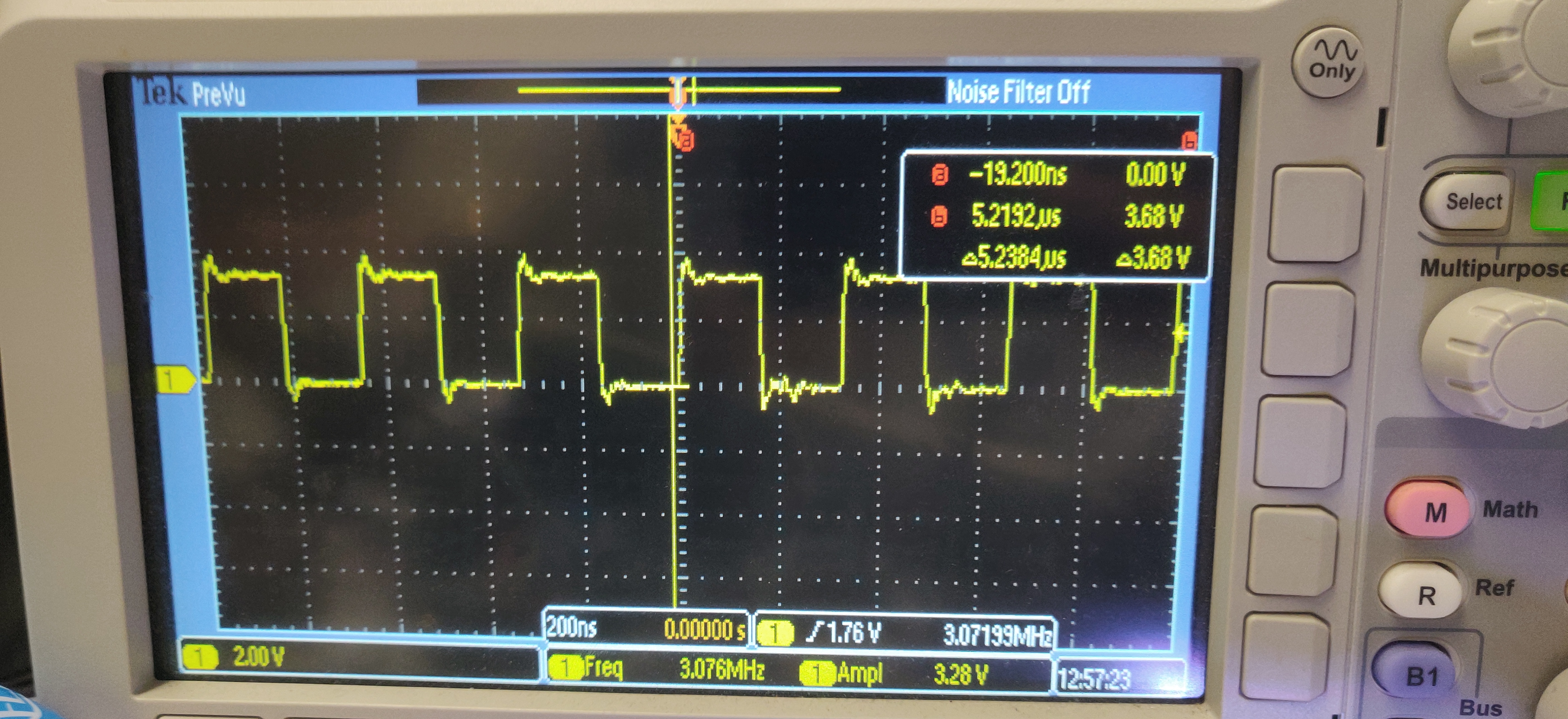

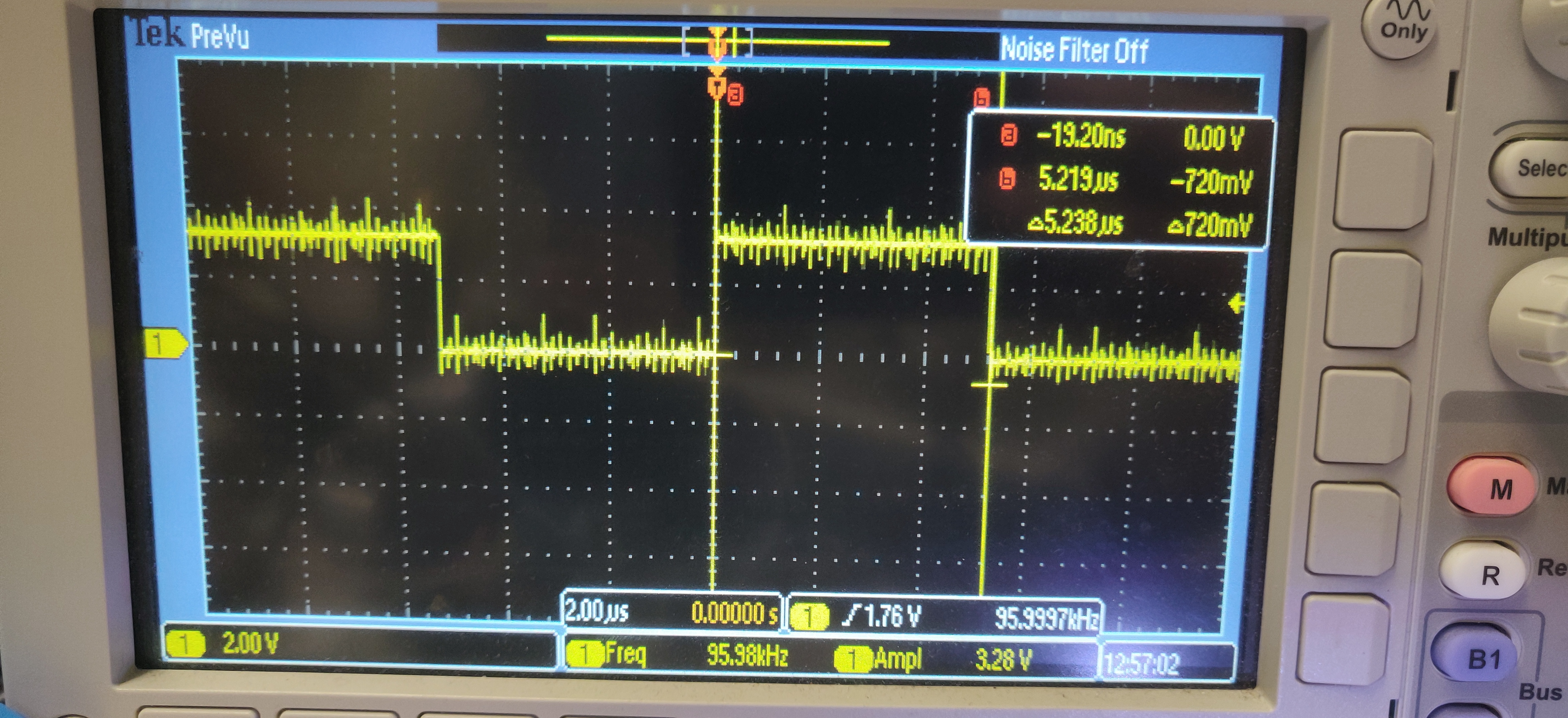

Re: I2S driver for ESP32 is not working [IDFGH-5854]
Strange, I tested signals on S3 at 96000Hz, here are my results from Oscilloscope, the clock seems not clipped
MCLK BCLK LRCK
MCLK BCLK LRCK

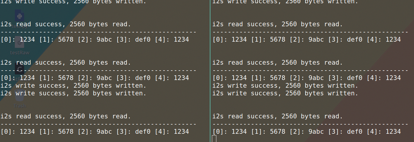

Another question, do you call any other I2S APIs after it is installed? The clock looks like disturbed by something.
Here is my test code and output for reference, I connect two s3 boards and set one in slave mode, another in master mode. at least the data seems correct.
These are the ouputs

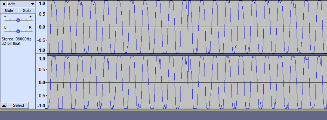

- Posts: 15
- Joined: Thu Jul 12, 2018 11:09 am
Thank you L-KAYA for explaining with example.

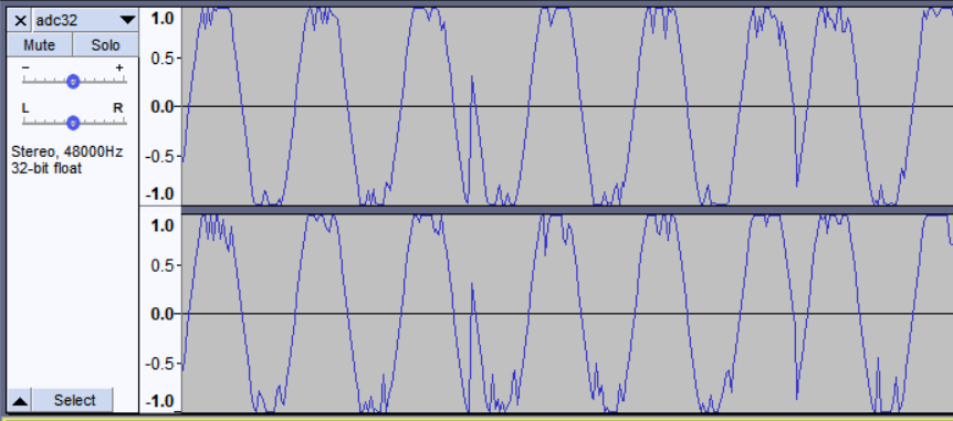

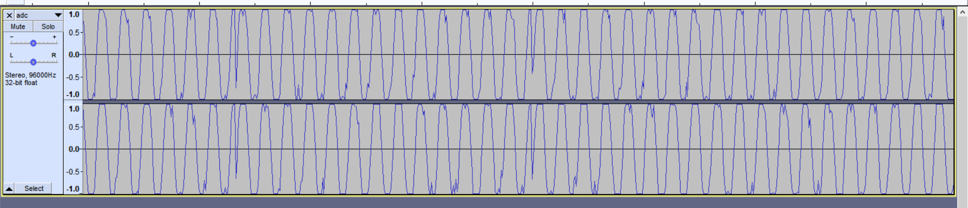

When I probed the MCK, BCK, LRCK with same setting, looks like outcome is matching with your sent images.
But problem is here, I am feeding 5Khz sine wave to external ADC, and capturing this data at 96000/48000 sampling frequency.
With the same code even with the correct clock on all pins, data is not coming properly. I have seen data missing in-between frequently.
Please find attached Captured sine wave image for your reference.
FYI, I have verified with ESP32 in IDF4.3, Data is absolutely prefect.

Can you let us know what things going wrong here.
Many thanks.

- data_singal_96k.PNG (65.5 KiB) Viewed 20465 times

Oh, I see, I just thought the output MCLK signal clipped. Sorry for the misunderstanding.
So as you mentioned, the signal on wires is correct but the reading data is not complete, some data seems to be dropped.
Since you're using event queue, the received data can be dropped if the event queue is overflow.
To check whether the queue overflow, you can catch 'I2S_EVENT_RX_Q_OVF' event on esp-s3 (esp32 and esp-s2 not support, It will support later).
If you can catch the overflow event, you can try following ways:
1. Try to Increase the length of event queue, I2S_DMA_BUF_CNT and I2S_DMA_BUF_LEN;
2. Input a max block time in 'i2s_read' like
i2s_read(I2S_NUM, (void*)pxMessage->ucData, i2s_read_len, &bytesRead, portMAX_DELAY);
3. If method 2 not works, please try not using event queue and reading data by `i2s_read` directly(use the code in method 2). Actually I think use event queue here is not that necessary.

1)As per your suggestion I checked for queue overflow, adding more validation for this 'I2S_EVENT_RX_Q_OVF' event.
However, I did not see any single time queue event overflow.
2)For extra safety, I increased queue to double the size. But the result are the same.
3) I have added max block time in 'i2s_read' call also, But the result are the same.
4) I removed event queue from code and captured data directly from i2s_read call by adding portMAX_DELAY as a last parameter.
Following are the code for that.
Find attached captured sine wave signal from other task for your reference.
Looks like here, there are something problem in I2S driver code in new IDF.
Can you help me to how figure out this problem.
Thanks for prompt reply.
- data_singal_96k_without_queue.PNG (106.21 KiB) Viewed 20406 times
Sorry to hear those suggestions didn't work. Then it should be an internal issue, I don't have an available ADC board currently, so, it should still take me some time to reproduce this issue, if I find any clue, I'll post here right away.
By the way, may I ask what ADC you are using?
