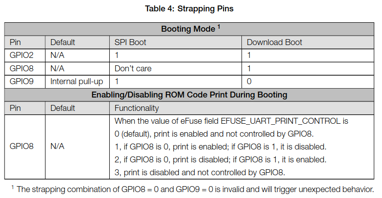

Hi. This is my first post here. Be gentle.
I've been experimenting with AiThinker ESP32-3CF and 3CU modules. The datasheets for these both show the flash download strapping pins being GPIO8 and 9.
Now, here's the pins.h file for the ESP32-C3 variant:
https://github.com/espressif/arduino-es ... _arduino.h
This specifies the I2C SDA and SCL pins also as GPIO8 and 9. I get that you're not going to be doing any I2C during flashing, but still, is this wise? There's going to be other hardware wired to those pins. Would it be better to use something like GPIO18 and 19?

If you take a look at the datasheet, you'll see the strapping pins table (see image):
This means that both GPIO's 8 and 9 can be used for I2C, since you'll have the pullups required by the I2C. The best to do is to test this on your board and see the results. Probably this gonna work.
The GPIO8 will not make any difference by adding the pullup resistor if you haven't changed the eFuse configuration.
