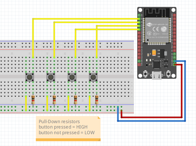

sivar2311
Joined: Sun Jun 12, 2022 3:48 pm
Re: Why are GPIOs 34 and 35 always LOW ?
Postby sivar2311 » Sun Jun 12, 2022 4:24 pm
I guess your wiring is wrong
GPIOs 34,35,36 and 39 needs external pullup or pulldown resistors.
The code to initialize these pins is
  pinMode(34, INPUT);
  pinMode(35, INPUT);
  pinMode(36, INPUT);
  pinMode(39, INPUT);
The code to read these pins is
  bool gpio_34_state = digitalRead(34);
  bool gpio_35_state = digitalRead(35);
  bool gpio_36_state = digitalRead(36);
  bool gpio_39_state = digitalRead(39);
There are no digitalWrite involved.
The state interpretation (pressed or released) depends on the selected wiring.
Pull-Up:
HIGH = released
LOW = pressed
Pull-Down:
HIGH = pressed
LOW = released
Here is the PULL-UP wiring:
Here is the PULL-DOWN wiring:
