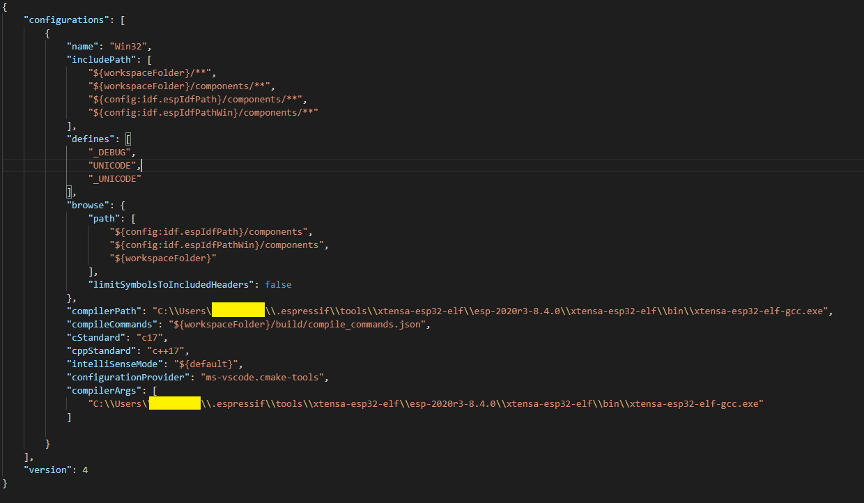

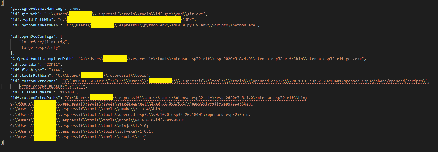

I am trying to configure the debugger in Visual Studio Code with a JLink. I am to a point where the debug session starts but nothing happen. Here is my Task.json, settings,json, c_cpp_properties.json and launch.json. Just note thats in settings the error is there only so i could fit everyting in the picture, its normally on the same line.
I posted here since i use espressif tools, dont know if its the right place.

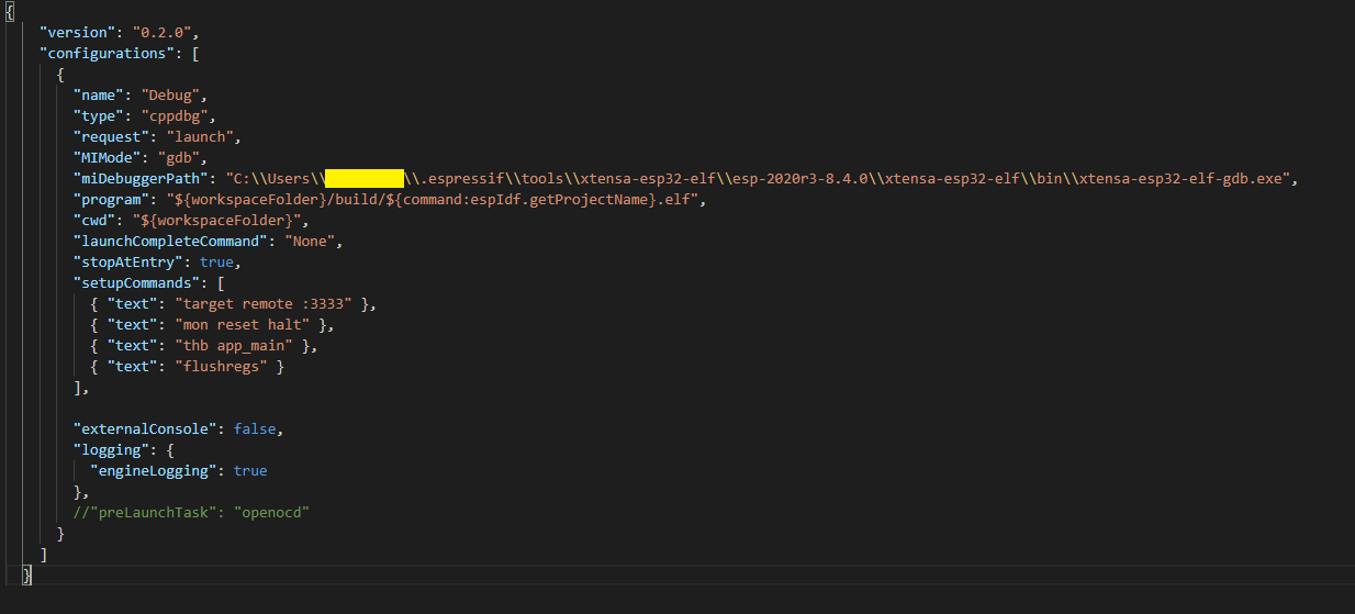

Here is the launch.json
