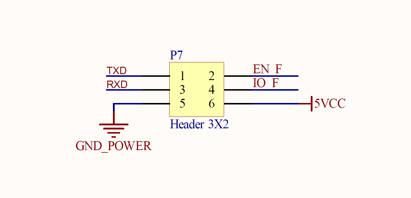

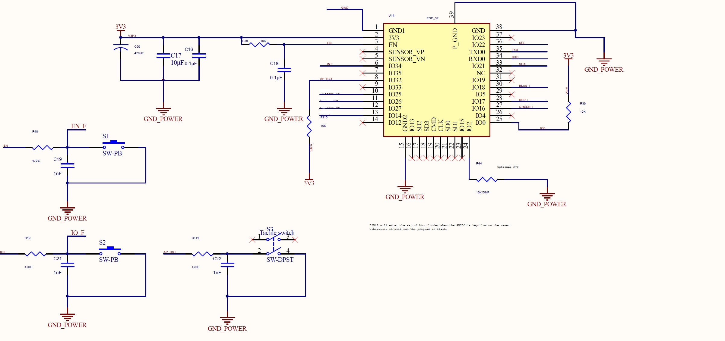

The flashing is done by pressing the EN button momentarily(ESP is reset) while holding down the IO0 button. So now the ESP32 will successfully enter the flash programming mode.
The flashing of Esp32 is done using switches S1(Enable) and S2(IO0) as shown in the schematic below. Also the header P7 is used
where CP2102 USB 2.0 to TTL UART Serial convertor is used for flashing firmware into the Esp32.

Hm, I can't see anything funky in your schematic... the 470 ohm resistors in series with the buttons certainly wouldn't be something I would do, but I don't think they are an issue here.
Can you connect a serial terminal program to the serial port and see what the ESP32 sends on reset, with or without IO0 pulled down?
Also, have you inspected the soldering on those chips? While you may not have a short, a dry joint could lead to an intermittent connection, breaking the flashing process.

Okay, no bootup message means either that GPIO15 is connected to ground (unlikely to be the problem as that would not prevent you from flashing the device) or the ESP32 module itself is not booting at all for some reason. As this bootup message is emitted by ROM, it's not dependent on anything put in flash. Suggest you take a very good look at the EN, Gnd and Vcc pins of the Wroom module, see if the voltage levels there are OK, see if the module is reset correctly. Possibly try changing R48 for a wire link or 0 ohm resistor as well, see what happens if you press reset with that.
