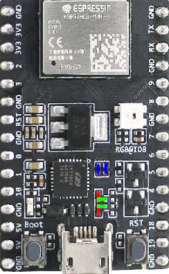

I recently received my ESP32-C3 mini development kit. I am pretty sure it is configured to use the CP2102 USB interface and so R1 and R4 are installed. I would like to use the internal USB JTAG interface which I understand requires the removal of R1 and R4 and installation of R2 and R3 (though I am not sure this is the case). This would also free up RXD and TXD, which I need to use.
I have not been able to find documentation on how to use the Devkits with the USB JTAG, nor have I been able to determine the location of R1, R2, R3, R4. I have tried "beeping out" the circuit but would prefer not to ruin my board.
Is there any guidance as to where those components are and/or how to use USB JTAG.

The PCB layout of that devboard can be found here. As far as I can see, you need to rotate those resistors 90 degrees: move them from the red to the green position in this image:
You probably also want to disconnect the RxD/TxD pins from the CP2104 to the ESP32C3 if you want to use those pins. You can do that by removing R21/R22, I marked those in blue.

Alas, I am not used to working with SMT parts as small as those resistors. I removed them OK but I could not solder anything in place. I used an ultra-fine pitch iron but the parts kept sticking to the iron instead of the board. I ended up screwing up the tracks.
Fortunately, I bought two development boards and I know I can fix my problem, either by soldering to the USB connector or the external pins.
