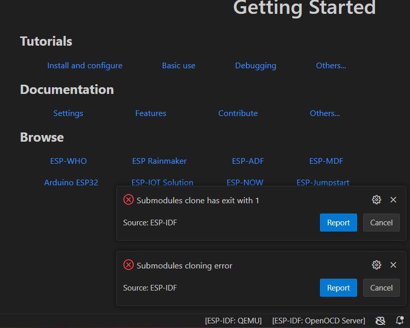

hyuan75
Posts: 18
Joined: Wed Jun 14, 2023 9:03 am
Re: VSCODE安装ESP-ADF插件失败
Postby hyuan75 » Sun May 05, 2024 1:18 am
我也遇到这个问题了,vscode安装esp-idf后用idf extension 安装adf(选择国内gitee源)最后总会报失败。请问报失败后手工如上改一下idf extension: Esp adf path win 到安装adf时选择的安装路径(C:\Users\dino\.espressif\esp-adf)即可是吗?然后不用理会报失败的信息?谢谢!
vscode安装esp-adf失败截屏错误:
