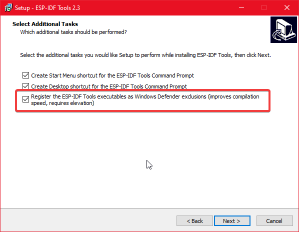

Re: Newbie User - ESP32-WROOM-32E
Hi Synectix,
the slow compile speed may be due to your antivirus software.
Please reinstall IDF-tools using the installer.
The installer registers the tools as Windows Defender exclusions to improve compile speed. After that, check if the issue persists.
If this doesn't fix the issue try disabling your antivirus software and post which antivirus you are using.
Thanks. Problem solved !
I am certain that I had enabled the "Windows Defender Exclusion" checkbox when I installed it the first time too.
Anyway, I uninstalled the esp-idf and re-installed with "Run as Administrator" option.
Now the eddystone project's build time is about 4 min 30 seconds !
