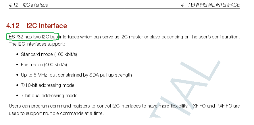

we have 3x I2C in the ESP32 release?
( beta was/is 2xI2C )
before wrote: 3 x UARTs, including hardware flow control
3 x SPI
2 x I2S
12 x ADC input channels
2 x DAC
2 x I2C <<<<<<<<<<<<<<<<<<<<<<<<<<<<<

in datasheet 2x I2C too
