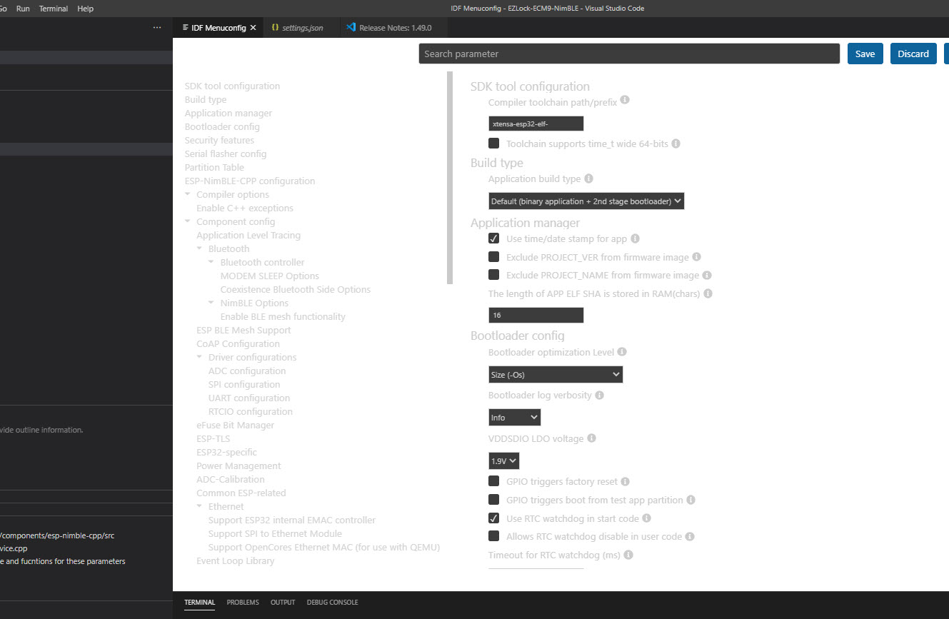

im using the default DARK theme.. and its suddenly got a WHITE background, and grey text (very hard to read)
i don't remember this being the case... i haven't programmed in a few weeks
but now got a new ESP32 project...
ESP-IDF ext version: 0.4.0
VSCODE 1.49.0 (just updated)
Win 10 x64 2004

This is a bug which got introduced while vscode updated to 1.49.x, we already have a PR to fix this.
https://github.com/espressif/vscode-esp ... n/pull/166

works... and thank you for the QUICK fix!

We have a fix, we are planing a release by this weekend (26-09-2020), once released if you are using extension from the marketplace your extension should update automatically.

The fix is released in v0.5.0, are you still facing the issue?

hey thanks buddy for the update! Yesterday I updated both vs code and the idf extension. It works well! I donot have any problem now!
