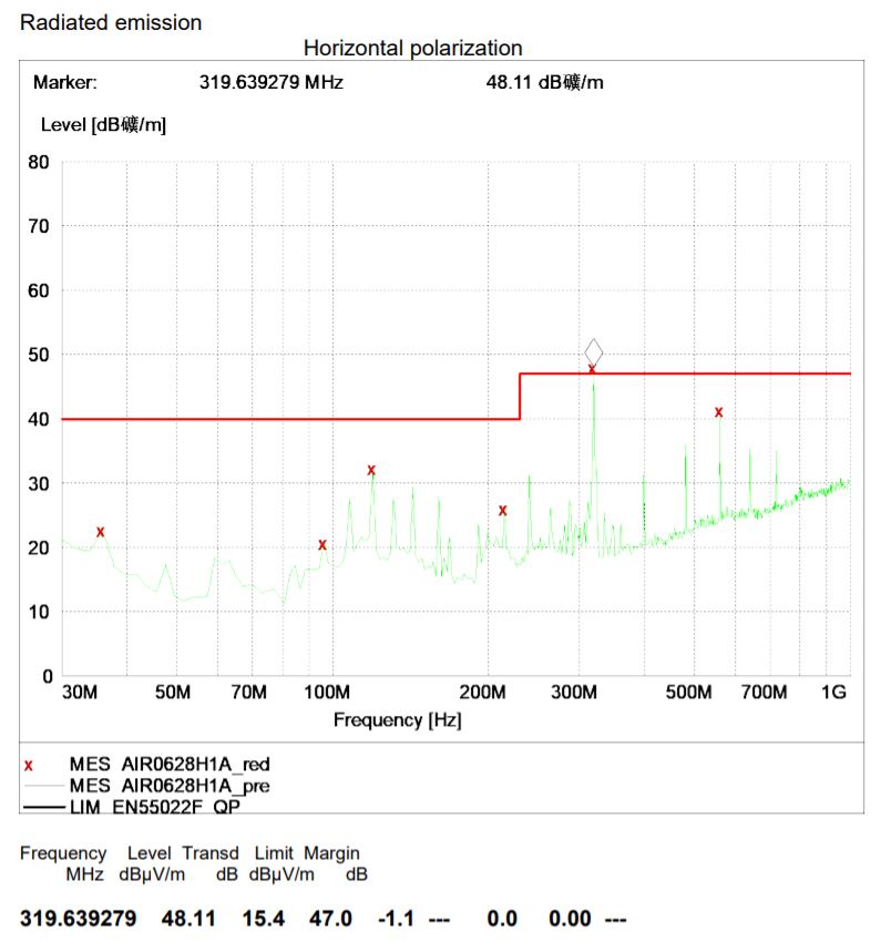

I am working on a commercial device that has the ESP32-WROOM-32D module inside. So far, in terms of the functionalities and performance, the module kick ass Nothing to complain about. But there is a problem when it comes to the EMC testing, and how I see it now, I have a couple of 80 MHz harmonics, and one (319.63 MHz) gives me a headache.

How does this sound to you? -> I would configure UART0 pins to GPIO, Outputs, and put them to logical 0 (LOW). That way, using low-side internal MOSFETs, the "harmonics" would go directly to the GND plane instead of radiating to the U0TXD line. Do you feel that I could reduce that 1.1dB of overshoot?

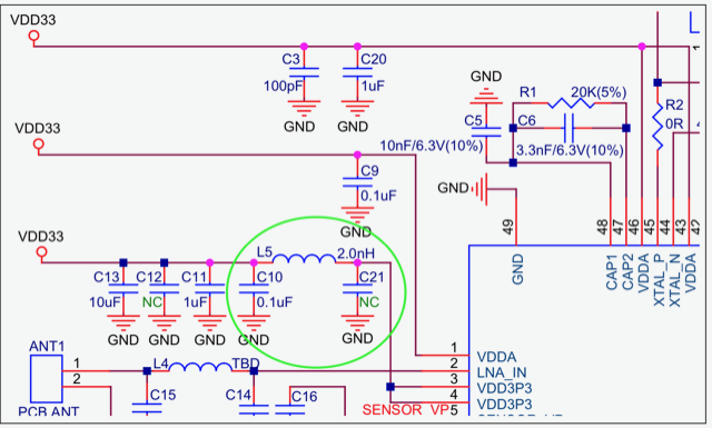

I asked around, it looks like the 80MHz actually is generated when the UART is outputting something. According to my colleague, disabling the TxD0 output and not connecting anything there should get rid of the harmonics. Not sure if it's still applicable to your situation, but he also mentioned that adding some decoupling of the 3.3V supply as indicated in the picture can help getting rid of 80MHz harmonics.

It's me again. So this might be a problem that others can face too with the ESP32-WROOM. The frequency of 320MHz is here to stay, for now, it's visible on communication lines, on the PCB, on the wires. It radiates all over the place, somewhere more, somewhere less.
Just to check whether is due to my board or the esp32, we used the esp32 dev module and saw the same 320MHz frequency which comes from the internal clock source.
Now the question is, what should be done on the firmware level to reduce the power of the emissions, to slow down or control in some way the PLL and clocks inside. The module is shielded but any line connected to the module will help radiate the 320MHz and other harmonics (400MHz, 480MHz...).
