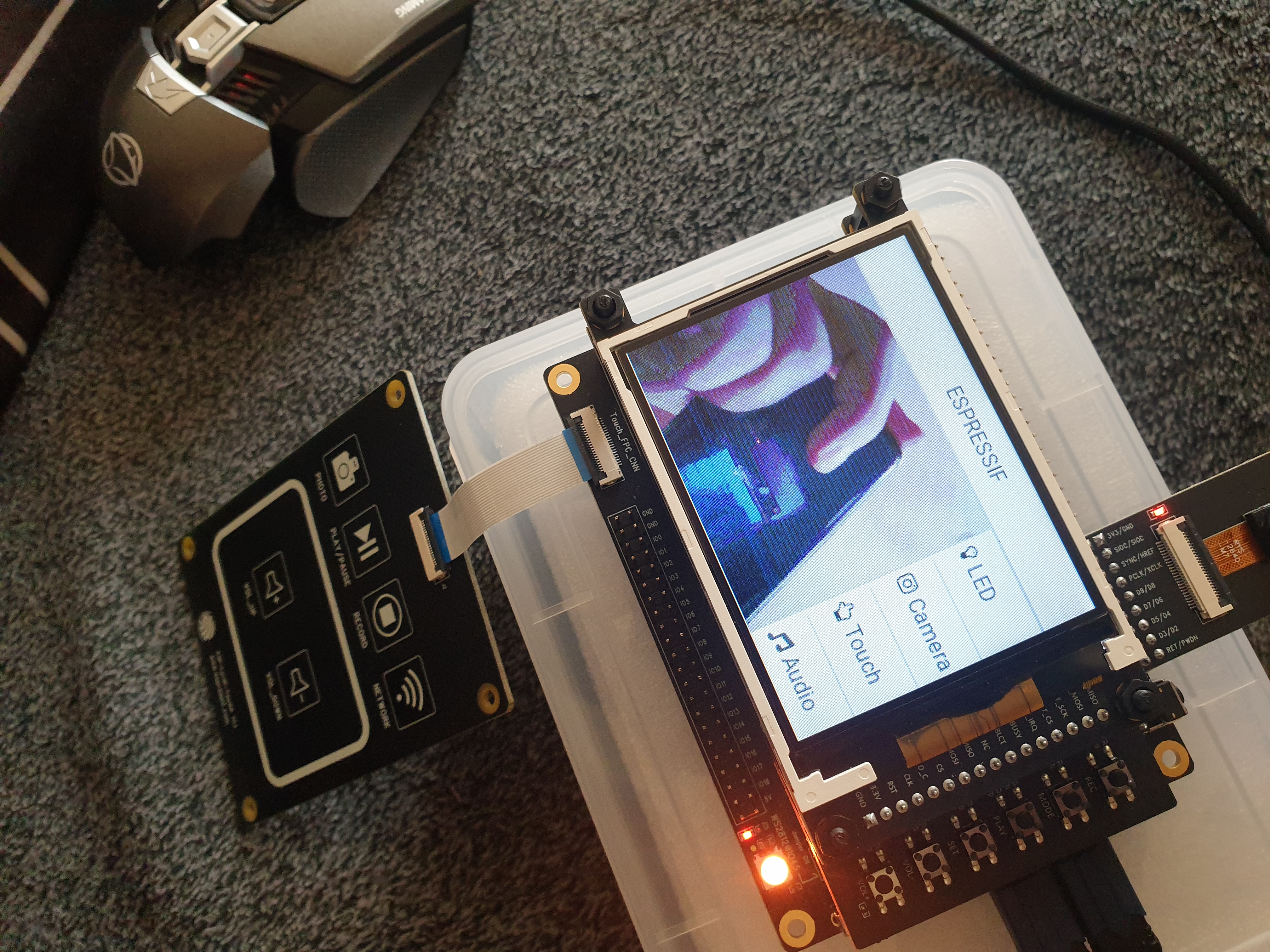

i just received new kaluga kit and it is awesome. For that price it come with LCD, camera, touch pad board, music board and of course esp32 S2 with FT2232C dual UART. Everything nicely packaged.
It is more question rather than complaining now. My board is behaving strange, because after reset with RST button i am getting such logs:
ESP-ROM:esp32s2-rc4-20191025
Build:Oct 25 2019
rst:0x10 (RTCWDT_RTC_RST),boot:0x19 (SPI_FAST_FLASH_BOOT)
invalid header: 0xffffff3f
invalid header: 0xffffff1f
Then it reboots after few seconds and the same logs. I have to use turn on/off switch to make it running with pre-installed demo app.
I have also question. I see that display should be touch screen capable, but its not responding, is it implemented in demo?
Is it intended in demo to display image from camera with dithered gray scale or maybe i am so unlucky and my example is damaged?

I tested with examples from https://github.com/espressif/esp-dev-kits and touch pad board does not react, display is working good and camera example is displaying the same picture as demo shipped with board, dithered gray scale.
Parts number i got:
- kaluga-1 v1.2
- camera LyraP cam v1.0
- touch board lyraP TouchA v1.1
- display LyraP esp32 v1.1 (ST7789V)
- audio lyraT 8311A v1.2

UPDATE after disconnecting display and audio boards touch pad board is working now
it is small chance its problem with USB power cable, even if power source is 2A

EDIT 2 after removing audio board, camera is working properly now
EDIT 3 after assembling everything back i made final test, powered boards with laboratory power supply straight to 5V and GND pins; current draw is about 150mA (3.3V and 200mA) and image from camera is bad quality, after removing audio board, just display and camera (3.3V and 160-165mA) and good quality image

Hi chegewara,
First of all, thanks for your understanding.
1. the issue with RST button:
Because the strapping 45 and 46 are used in the camera and audio board, these two would interfere the RST function. This would be updated in V1.3 later.
2. The LCD screen in the kit is not a touch screen, we wanted to show a simple GUI and showed what the boards can do, but it seems to be very confusing with the GUI. We will update the demo too.
V1.2 is compatible with a touch screen, but in V1.3 we would remove it and simplify the design, as a touch screen requires too many pins. We might design another board with touch screen only.
3. For the camera display issue, it's caused by IO46, pulled-up in the audio board, which interferes the output of the camera. You can remove the audio board and try the camera function again, it should work fine. It's mentioned in the readme of camera demo.
4. For touch pad issue, you would need config the DIP switch, also mentioned in the readme.

ESP_LBB wrote: 3. For the camera display issue, it's caused by IO46, pulled-up in the audio board, which interferes the output of the camera. You can remove the audio board and try the camera function again, it should work fine. It's mentioned in the readme of camera demo.
Thanks for info, im not educated and i dont know Chinese, sorry.
Im happy its not problem with hardware just problem with design, i can live with that. Lucky for me audio board is least useful part at least for now.

I just found that kaluga board has hardware motion detector. I never saw something that smart before.
On board LED ws2812 data pin is connected to camera D3 pin. Almost always change in camera image is reflected in color changes of LED.

I am studying kaluga schematics now and i can see that USB pins (19 and 20) should be connected to D+/D- to USB connector. I didnt test it with multimeter or any other equipment, but i can say that linux cant see it when i switch device to dfu mode, but when i connect wires straight to pins 19/20 i can see it thou. Just guessing now, but probably pins might be reverted.
I found that touch pad DIP switch is also controlling extension board pins. For example turn off pins 2, 3, and 7 on SW4 (any of them) causing my LCDis not working. Those are MISO, MOSI and D/C pins on LCD. Why?

Like i said, ive been studying schematics too:
https://dl.espressif.com/dl/schematics/ ... 00424A.pdf
page 4, 4C, we can see USB D+/D- connected to EXT19 and EXT20. Thus my question, why its not mounted as DFU device, which obviously works when i wire pins 19 and 20.
I have more strange behaviors. For example i have all touchpad DIP switched OFF, just for test. Guess what, touch pad is working. Readings are inaccurate (i can accept that, switches are OFF), but this also i causing that i cant use LCD, Like i mentioned, pins shared between LCD and touchpad, when switched OFF on DIP (any LCD pin) cause LCD being unusable.
Conclusion:
- i cant use touchpad with LCD, audio or camera,
- i cant use audio with camera or LCD,
- hopefully i can use camera with LCD,
- no simple option to use DFU, even having 2 USB connectors on board,
- i didnt check JTAG yet, but there is chance it works, because its using.
Honestly, its a waste of money for board, not even a beta, but v1.2. Im not saying about software support, because this is WIP and can be fixed, but hardware issues cant be solved. In addition espressif knew about at least few problems, but i dont see any annotation in official docs about it, which could let me make decision if i want to buy it and deal with those isssues or wait for next, maybe a better revision.
