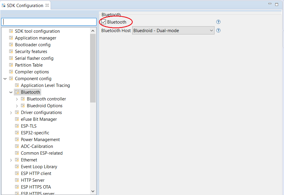

While i was writing a component about ble functions, i've met this error:
../components/ble/ble.h:9:20: fatal error: esp_bt.h: No such file or directory
although i've put bt in cmakelists for the custom component
set(COMPONENT_ADD_INCLUDEDIRS .)
set(COMPONENT_SRCS "ble.cpp")
set(COMPONENT_REQUIRES spi_flash mbedtls mdns ethernet)
set(COMPONENT_PRIV_REQUIRES freertos fatfs nvs_flash app_update spiffs bootloader_support openssl bt esp32)
register_component()
is it because the bt needed to be enable or some? it normally work for me this way to make a component, just not ble before.
thanks in advance

It seems that your bluetooth disabled, you need to enable it in menu config, you should not directly add it in your cmake.
this solves the problem perfectly, thanks alot
