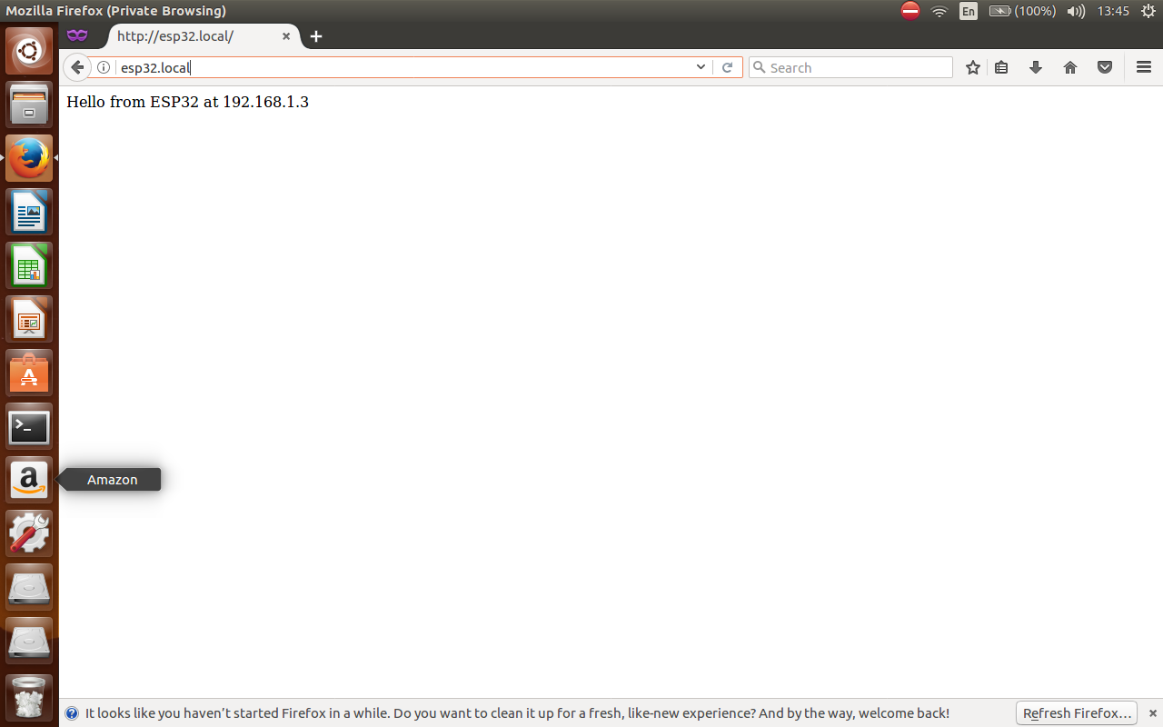

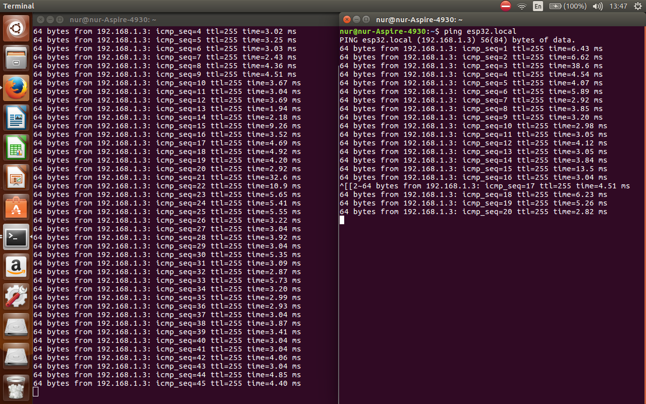

Joined: Sat Aug 19, 2017 11:27 pm
Re: ESP32 - Arduino - Connecting to a local server
Postby niddaas » Sun Aug 20, 2017 12:11 am
I just realize that the error is came from my windows 7. Because I can open the page in my ubuntu and have ping too. Here I attach the relevant screenshot.
Is there any other idea to playing mdns well in windows 7?
Thank you,
Saaddin Nur
