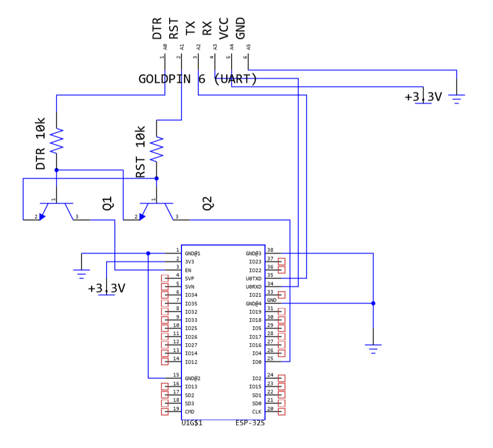

Hi, i just write minimal wiring for ESP32S, i want automatic go into boot mode without any buttons.
I want to ask u, that this wiring is correct ? After program i will use OTA. It will be dual PIR sensor (so i use extra 2 input in ESP32S).
Adnotacja 2020-04-04 173744.png (78.21 KiB) Viewed 4683 times

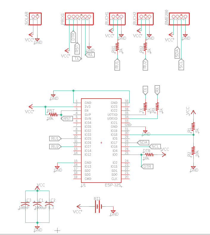

I change a little my diagram. Is it okay ?
