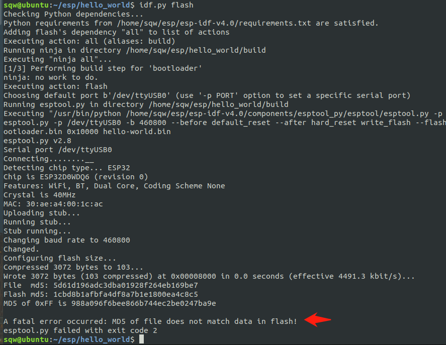

idf输出如上所示,我用的是ESP32比较早的开发板,是ESP32-S,最开始能够下载运行,后来运行spi receiver 历程并修改代码后出现此情况。
idf.py 下载程序,MD5不匹配导致下载失败

As indicated here
https://forum.m5stack.com/topic/838/a-f ... a-in-flash
I managed to solve error "A fatal error occurred: MD5 of file does not match data in flash!" with following WRITE FLASH command :
esptool.py --port <YOUR PORT> write_flash_status --non-volatile 0
1) BEFORE activating WRITE FLASH command, upload to ESP32 generates error :
Hash of data verified.
Compressed 229344 bytes to 112708...
Wrote 229344 bytes (112708 compressed) at 0x00010000 in 1.6 seconds (effective 1161.2 kbit/s)...
File md5: e68beba9df55b1cadc51a9c4b44004c0
Flash md5: 12b54d37dda6d321d283034959c4b6d2
MD5 of 0xFF is e14ab325b06643bd719d9f0fe4beae74
2) WRITE FLASH
Using Arduino IDE (ESP32 WRover module), under Windows 10, so exact commands for WRITE FLASH are :
cd C:\Users\<YOUR NAME>\esp\components\esptool_py\esptool
python esptool.py --port COM12 write_flash_status --non-volatile 0
esptool.py v2.9-dev

Initial flash status: 0x4200
Setting flash status: 0x0000
After flash status: 0x0000
Hard resetting via RTS pin...
3) AFTER WRITE FLASH command, upload to ESP32 is OK, error is no longer generated
Leaving...

There can be several reasons for this error message. In my setup, I am seeing this error message quite often. In all those cases it is related to the JTAG debugger. After I have disconnect and reconnect the debugger USB cable, the problem goes away.
I have not been able to determine why and when the debugger interferes with the flashing process.
