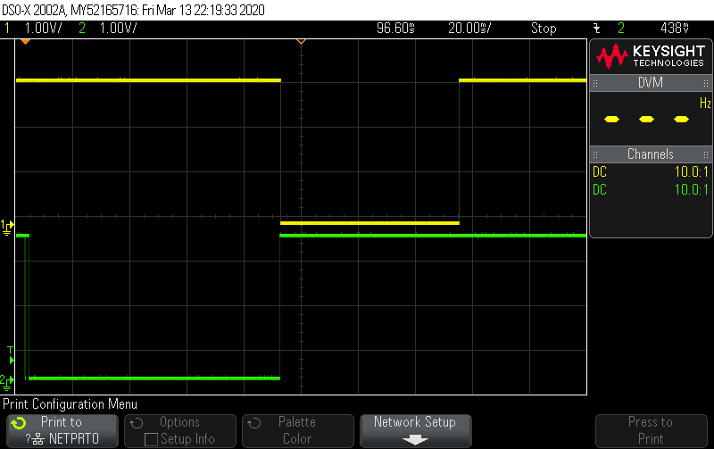

Hi guys,
I'm working with an inherited custom board which is using an esp32-d0wdq6. When programming I get an error stating "Failed to connect to ESP32: Timed out waiting for packet header" and "ESP32 Chip sync error esp_sync_blocking".
I have tried various programming tools to flash the chip such as Arduino(esptool.exe), esptool.py, flash_download_tools_v3.6.8. Also, I am using a TTL-232R-3V3 USB to TTL converter to interface with the board. I've had previous experience with programming an esp32-PICO in another project which was in-circuit and I've programmed with this method and experienced no issues. All I had to do was hold GPIO0 LOW and toggle the RST and it flashed perfectly
The esp32 is placed in circuit to be programmed via USB, however I have bypassed this and connected directly to the chip's I/O pins and powering directly via PSU (because the chip is currently not programmed and the USB is not being detected). I can't share any circuit schematics but I can detail the strapping pins I have configured for downloading (Although I believe the circuit is very similar to that of the esp32-DEVKIT).
I have read many forums stating how to configure the strapping pins and I think I have done so correctly:
GPIO0 - held at 0V
GPIO2 - floating
MTDI - held at 0V
CHIP_PU - Toggled manually 0V to VCC to enter programming mode
Toggling the CHIP_PU from LOW to HIGH I get an output of the following seen on PUTTY:
  1. ets Jun  8 2016 00:22:57
  2.
  3. rst:0x1 (POWERON_RESET),boot:0x3 (DOWNLOAD_BOOT(UART0/UART1/SDIO_REI_REO_V2))
  4. waiting for download
When I attempt to program the chip I get a timeout consistently.
I have an older version of the circuit which is in production, and programmable through the USB. There's been no changes in the current hardware design to affect the programming. I tried flashing the old circuit with the direct connection method via the USB to TTL converter, I get the same issue.
Reverting back to programming the old circuit with USB, it programs successfully. I monitored the GPIO0 and CHIP_PU lines during a successful program by the Arduino IDE and I caught the following:
Yellow ch: GPIO0
Green ch: CHIP_PU
This sequence of toggling seems quite complicated and it isn't stacking up with what I'm reading on the internet. Is it a matter of holding GPIO0 at LOW and toggling CHIP_PU? Or is it much more complicated sequence of handshakes? Is it possible to piggy back off an esp programmer or a devkit?
I hope you can help out :D
WiFive
Posts: 3529
Re: Issue with programming/flashing ESP32
Postby WiFive » Sat Mar 14, 2020 8:54 am
If you get "waiting for download" you're doing the strapping correctly. Could be a problem with the tx of your usb adapter.
chegewara
Posts: 2378
Postby chegewara » Sat Mar 14, 2020 9:28 pm
Try MTDI pull HIGH. When MTDI is wrongly pulled then you can enter download mode:
but you wont be able to upload code, it will end up with something like that:
Uploading stub...
Running stub...
Stub running...
Changing baud rate to 921600
Changed.
Configuring flash size...
Warning: Could not auto-detect Flash size (FlashID=0xffffff, SizeID=0xff), defaulting to 4MB
A fatal error occurred: Timed out waiting for packet content
If you wont get this, then MTDI most likely is fine:
https://github.com/espressif/esptool/wi ... -Selection
evanfahy
Joined: Fri Mar 13, 2020 9:27 am
Postby evanfahy » Mon Mar 16, 2020 11:02 am
I did a quick check of the Tx of the USB adaptor, using a serial monitor and shorting the Tx and Rx. I'm echoing back all transmits so I think the Tx is functional?

chegewara
Posts: 2378
Postby chegewara » Thu Mar 19, 2020 5:51 pm
I see here progress. This is not the same error:
Usually this means that you need to use EN and BOOT buttons to enter download mode. Usually which does not mean its your case, but worth to try.
