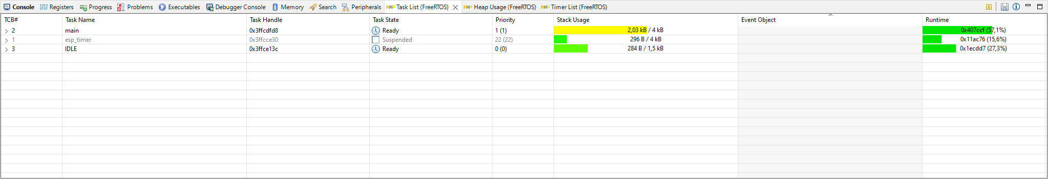

Re: FreeRTOS Task Aware Debugger?
ST has the same and I like it so I fixed it on eclipse for ESP (Only tested for ESP32-S2 and mostly interested in cpu usage)
VSCode is awesome for developing but its awful for debugging in my opinion...
1. Install FreeRTOS Task Aware Debugger from http://freescale.com/lgfiles/updates/Eclipse/KDS like this guide https://mcuoneclipse.com/2017/03/18/bet ... n-eclipse/
2. tick in sdkconfig: Component Config -> FreeRTOS -> Enable FreeRTOS to collect runtime stats
3. Go to esp_idf_components/freertos/tasks.c
Find: PRIVILEGED_DATA static uint32_t ulTotalRunTime = 0UL;
(It's at line 430 now)
a) You can either add "volatile" in front of it:
b) Disable GCC optimization for this variable:
Future prof notice: If something doesn't work you can open the nxp jar located in \tools\espressif-ide\2.6.0\plugins with "jd gui" and view what variables tries to read. If something is "optimized out" while debugging you have to make it volatile so the plugin can read its value. I don't think that ESP team changed FreeRTOS variable names so it will be just the optimization if something doesn't work.
volatile PRIVILEGED_DATA static uint32_t ulTotalRunTime = 0UL;
#pragma GCC push_options
#pragma GCC optimize ("O0")
#pragma GCC pop_options
