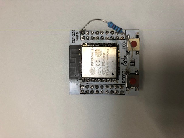

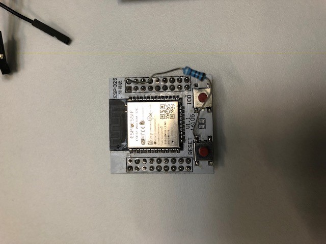

Since 2 days, I try to understand why I can't program my 4 esp32 wroom 32D that I received. I am using Arduino IDE and an FTDI adapter to program. I did several tests, everything works correctly when I program an esp-WROOM-32 but as soon as I want to program the 32D it does not work.
AT the end of the programming I have this:
esptool.py v2.6
Serial port COM7
Connecting........_____....._____....._____....._____....._____....._____.....____An error occurred while uploading the sketch
_
A fatal error occurred: Failed to connect to ESP32: Invalid head of packet (0xF0)
My PCB and ESP32-WROOM-32D failled:
https://github.com/Christophe45/ESP32-L ... oom-32.jpg
My PCB and ESP32-wroom-32 working:

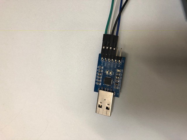

My FTDI :
https://github.com/Christophe45/ESP32-L ... daptor.jpg
I press the right buttons to program. I know my ESP-32-wroom-32D is working fine because when I use and other programmer it working fine

- esp32-wroom-32D.jpg (60.5 KiB) Viewed 5057 times
- esp32-wroom-32.jpg (53.16 KiB) Viewed 5057 times

try searching for "Strapping Pins" in the documentation of the ESP32.
The "other Programmer" already has resistors pulling Up the Enable-pin and IO0 (RST/PROG)
Guess this is what you're missing.
try google-images of "esp32 boot pins" you'll find plenty of wiring examples
or try to program the ESP32 outside your "other programmer", you will find out that you need to connect 6 wires in order to get it working: 3V3, GND, EN, IO0, RXD, TXD
