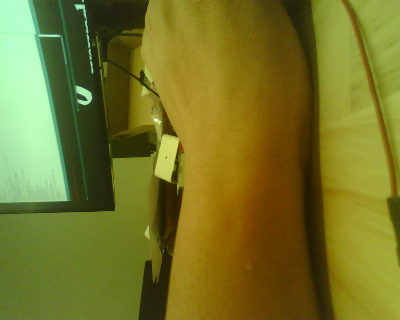

I was debugging my image capturing program recently. My problem is when I configured the sensor with all default settings except the resolution. So the initialization code is:
sensor_t * s = esp_camera_sensor_get();
s->set_framesize(s, FRAMESIZE_SXGA);
And the image becomes like this:
The image's color is quite yellow.
It was clear that the problem is related to white balance.
So I turned on automatic white balance with following code:
s->set_whitebal(s, 1);
s->set_awb_gain(s, 1);
s->set_wb_mode(s, 0);
But there is nothing changed to the image.

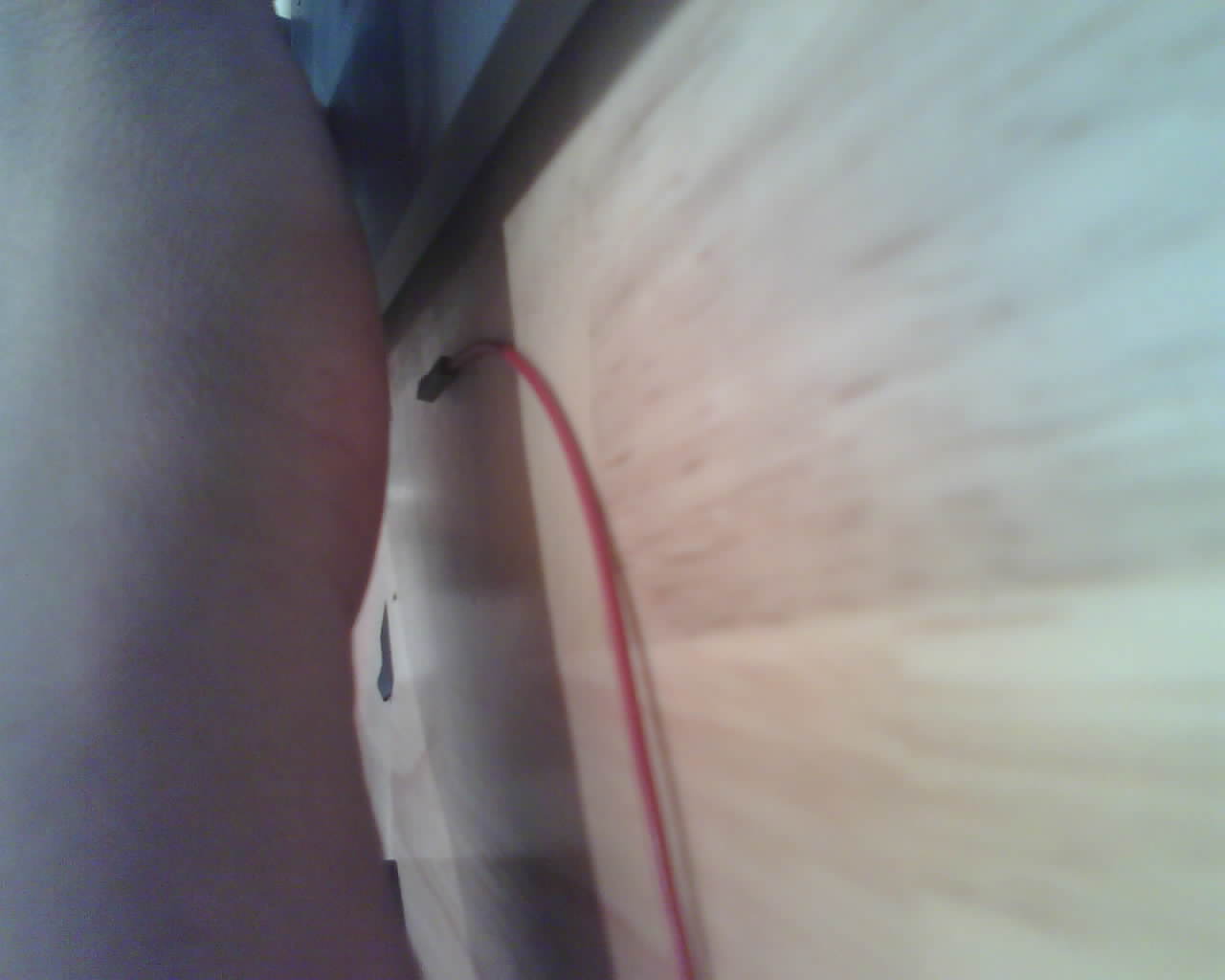

The I referred to the official example of WebCamServer:
I changed the resolution on the index page and press "Get Still", then the image seems quite satisfying. The color becomes normal.

it takes time for the sensor to do white balancing (up to 5 seconds in my case)
