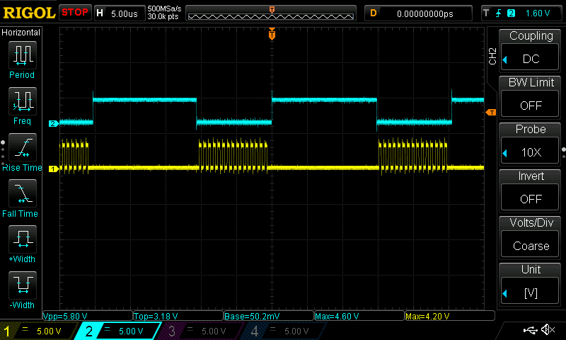

Re: 100K spi transactions per second
I have attached a scope shot with the Chipselect and clock lines.
As you can see, the issue is not the clock speed, but rather the long intervals between transactions.
I don't think raising the clock speed would increase my sampling rate by more than maybe 20%, and there is some practical reasons in my PCB which means that i would like to avoid needing to create a 5V supply
- DS1Z_QuickPrint1.png (41.28 KiB) Viewed 5703 times
15us intervals do seem excessive.
Perhaps there is a configurable parameter in the spi master library or the rtos for minimum cs enable/disable periods?
If not, maybe you could use the ulp to handle the spi transactions?
Or use interrupts for spi receive and handle them on the other core?
Worst case, write your own spi handler.
