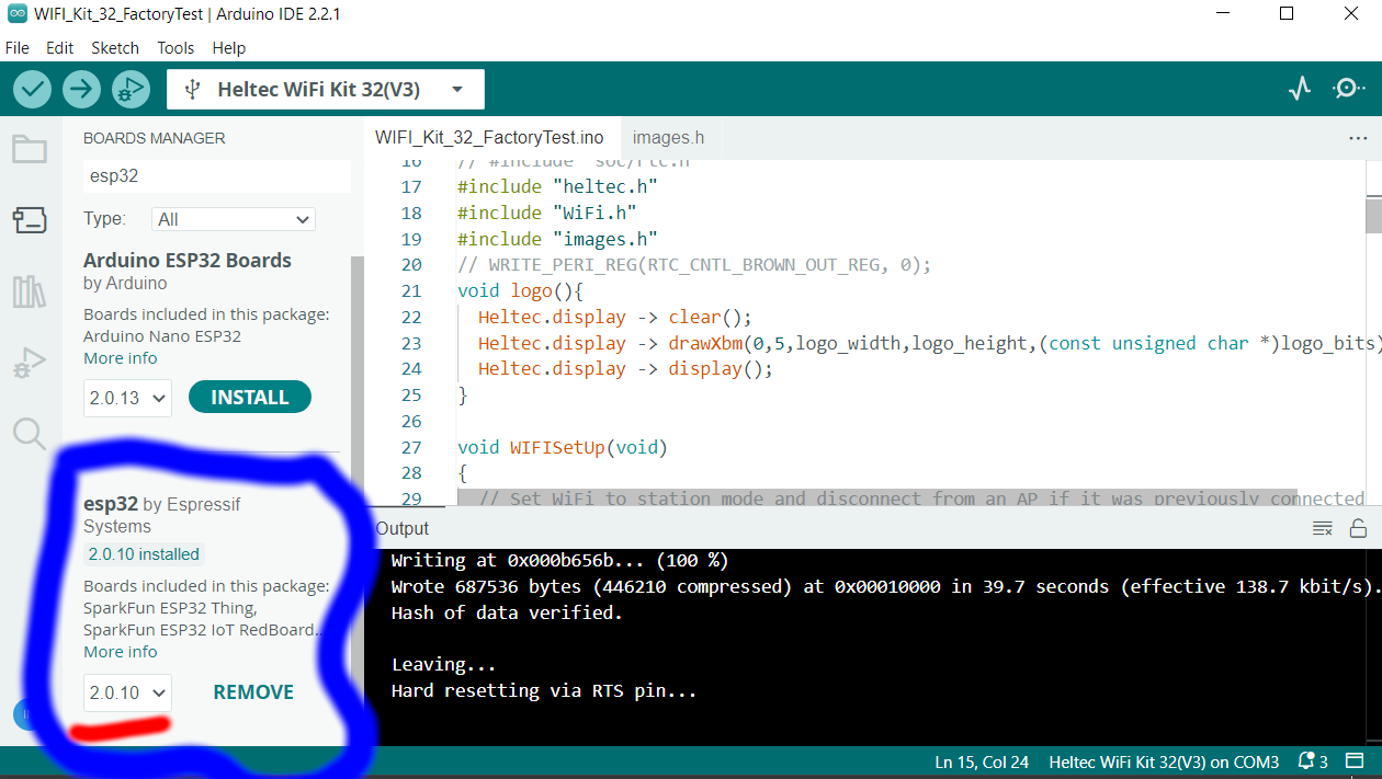

infernox64
Joined: Fri Dec 22, 2023 8:23 pm
Re: ESP32 Keeps rebooting after code uploaded
Postby infernox64 » Fri Dec 22, 2023 8:32 pm
To anyone still having this problem:
I solved it simply by downgrading the esp32 board package by espressif in the arduino board manager.
if your version is 2.0.11, select 2.0.10 and install that instead. it will replace the newer version automatically.
Apparently 2.0.11 breaks a bunch of libraries including the Heltec libraries, if you have one of those boards
krunalramkar
Joined: Tue Jul 23, 2024 3:06 pm
Postby krunalramkar » Tue Jul 23, 2024 3:08 pm
Thanks for Downgrade ESP32 to 2.0.10 from Board/Library management in Ardiuno IDE its stop resetting Problem i have Solved problem by this Thanks :D
