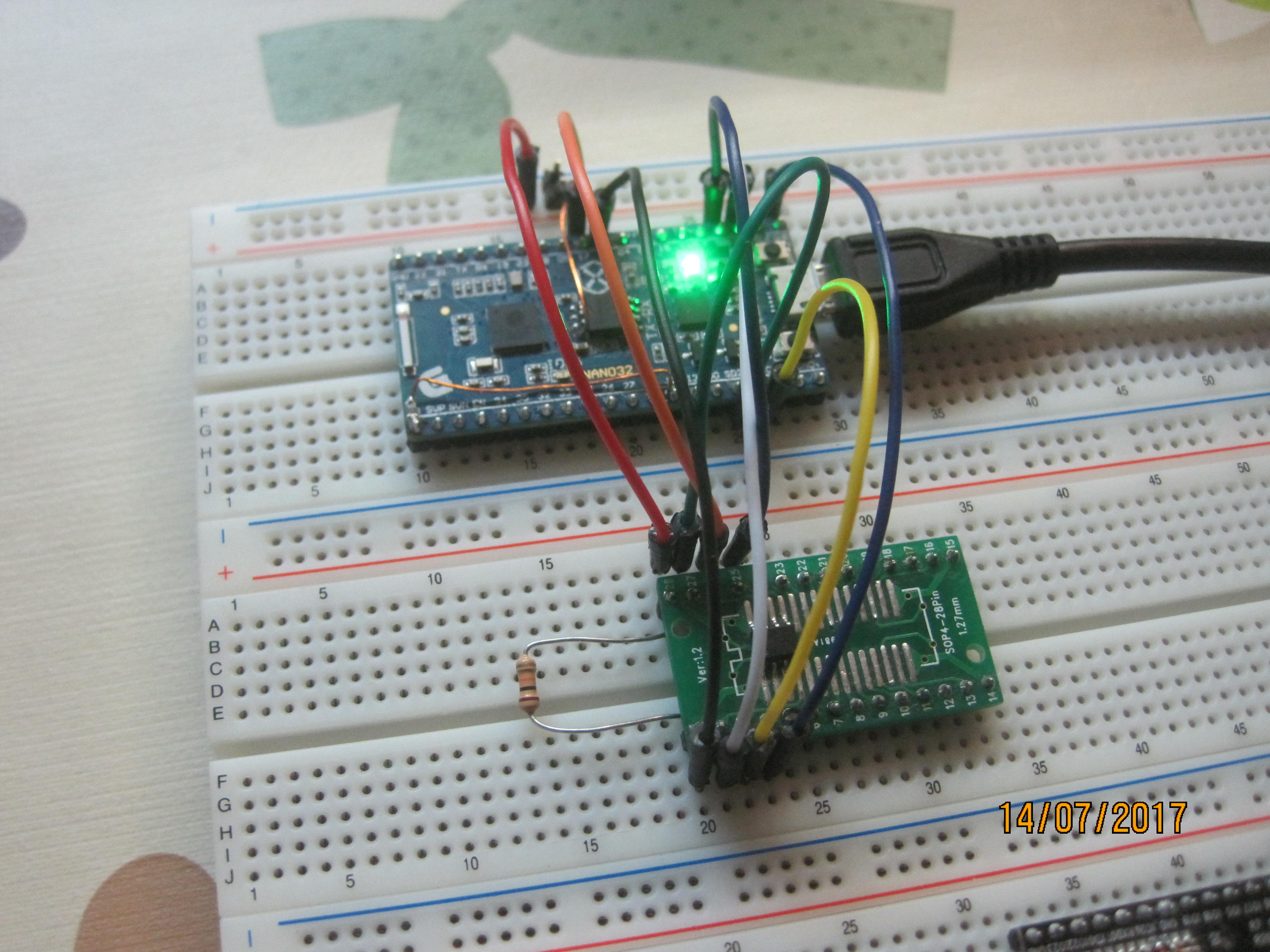

Re: Small ESP32 Modul ( all include in new ESP32-PICO )
Ok, I wired it all up on a Frog Board I got on tindie... it's the only board I have with everything broken out that I needed.
And here are the results!

So, ram still not working, but much closer to 100% pass rate!
No idea where to go from here other than wait for new ram and try that on both boards.
Yeah it's a miracle it works that well with those long wires and different lengths on a high speed 4-bit parallel interface.

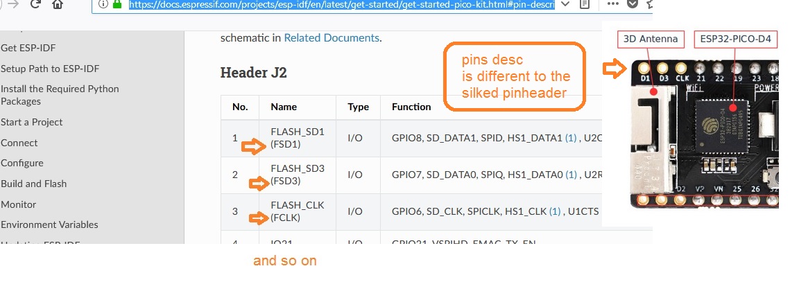

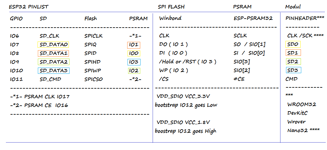

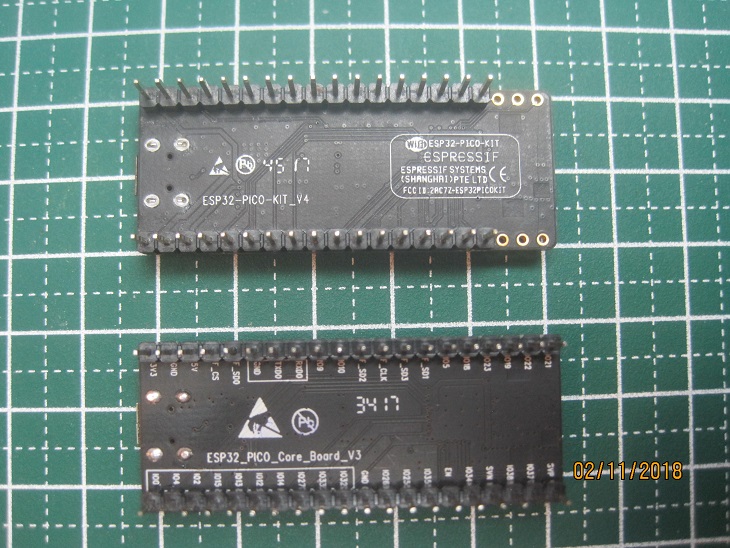

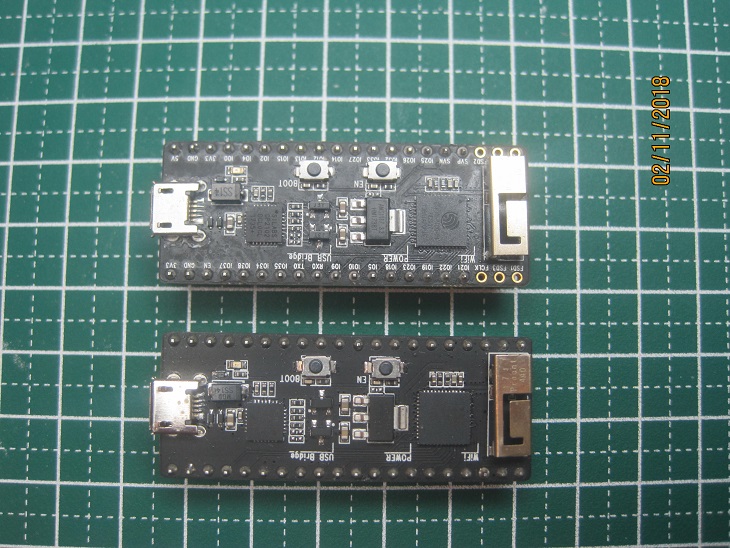

good morningrudi ;-) wrote: ..
how you connect PSRAM ( 3.3V ) to the PINHEADER of Pico-D4 ? ( FSD0, FSD1, FSD2, FSD3 )
which pins you use for PSRAM CS# and CLK ?
don't use FCLK ( flash clock ) for psram CLK
don't use FCS ( flash cs ) for psram CS#
PSRAM
PIN1(CS#)= "hope you use IO9"
PIN2(SO/SIO1)= ??
PIN3(SIO2)= ??
PIN4(VSS/GND)=
PIN5(SI/SIO0)= ??
PIN6(SCLK)= "hope you use IO10"
PIN7(SIO3)= ??
PIN8(Vcc)= ??
can you say how is your wire on the sd0 sd1 sd2 sd3 pins ?
btw which pico-d4 version is the board you use ?
cause sd0 sd1 sd2 sd3 is silked on the top in your pic's,
usually it is silked on bottom (v3)
usually it is silked on top (v4) but FSD0 ..
rudi

SIO[0] - GPIO8
SIO[1] - GPIO17
SIO[2] - GPIO7
SIO[3] - GPIO11
On WROOM32 I am using
CS - GPIO16
CLK - GPIO7
SIO[0] - GPIO8
SIO[1] - GPIO17
SIO[2] - GPIO10
SIO[3] - GPIO9

Hi Seon
my V4 is silked on top with FSD0 FSD1 FSD2 FSD3 FCLK FCS
the V3 is silked and tracert on this pinheader other PINS like IO21 IO22 and so on ( see pic )
( edit: V3 is silked on the bottom side)
will try to check asap your pins comparing with my setup ..
btw
i saw the getting started docu now too
the pic on the docu pointed to an other Pico Kit D4 Version
where the PIN description talk from F..SD0 SD
@Angus can someone update the Board Pic
or the Pin Header Description, onethings is here not up2date
i have no V4.1 just in time in the hand so i can not check what is wrong / not up2date.
(edit: insert compare pic for better understand what is mean )
rudi
