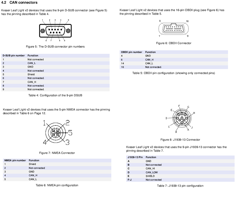

Re: About the CAN controller.
@jcsbanks
can you test the thing with alternative transceiver MCP2551 or TJA1051
.. i read you connect to the ESP32 Kvaser ..
- Kvaser Leaf Light HS v2
- Kvaser Leaf Light HS GI
- Kvaser Leaf Light HS v2 CB
- Kvaser Leaf Light HS v2 OBDII
i think you use: Kvaser Leaf Light v2 HS. Item No. 00685-0
can you point me to your used hw type in detail, please.
ok, you say,
if Kvaser send - then ESP32 is receive well
so the Tx from Kvaser goes ?...
- to an CAN Transceiver?
- to the Rx GPIO from ESP32?
importants are:
which high pegel does Kvaser use for sending / receive
cause ESP32 is 3.3V perhabs the Tx of ESP32 is not enough to the Kvaser?
usually goes here in CAN Transceiver ( MCP2551) <-> MCU ( ESP32 )
Rx to Rx
and Tx to Tx,
( not crossed like in USB TTL adapter.)
and cause ESP32 3.3V the pins must be level shifted if more or lees as 3.3v
i use the MCP2551 and connect it to esp32 GPIO4(rx) and GPIO5(tx)
the line on MCP2551 CAN_H and CAN_L is terminated with 120 Ohm and goes 100 m on a bus cable
the GND is connected to the GND/mass of the bus cable if i use a second Laptop for connect DevKitC on USB
on the other side there is the same ( DevKitC V2 and MCP2551 )
and the lines CAN_H and CAN_L are terminated with 120 Ohm
the Rx and Tx from MCP2551 goes to the ESP32 GPIO4(rx) and GPIO5(tx)
cause MCP2551 need 5 V ( so there comes a 4.78 V Pegel on Rx! )
i switched in the RX line a resistor ( 10 kOhm ) in the line
MCP2551 Rx---------Resistor 10kOhm--------ESPGpio4
so the rx signal has max 3.65V on gpio4 if high
btw:
do not do the same! can destroy your ESP32!
i have tested without this resistor too, and ESP32 works with this 4.78 V too,
but for the protocoll here - do not use this 4.78 V on ESP32 - this can destroy your ESP32
i have more ESP32 here for testing these things ( it works shortime with 5.23V too ) but this is unofficial! )
btw have you try to comment the line in the receive func
before
after
let me know which Kvase you use and is there a CAN Transceiver on ESP32 or goes the RX TX line to the Kvase? ( Can_H, CAN_L )
cause like you can see,
Kvases have CAN_H and CAN_L
and you can't connect them to GPIO of ESP32 for "rx" and "tx" directly
you need a CAN Transceiver between Kvase and ESP32.
but i read
thank you
rudi

Thanks rudi.
Yes I am using Kvaser Leaf Light v2 HS with OBD plug.
SN65HVD230 CAN bus tranceiver (3.3V).
Kvaser Leaf CAN H to SN65HVD230 CAN H.
Kvaser Leaf CAN L to to SN65HVD230 CAN L.
Kvaser Leaf GND pin 5 (signal ground) to to SN65HVD230 GND. I will try Kvaser Leaf GND pin 4 (chassis ground) and will also try without a ground connection
SN65HVD230 GND to ESP32 DEVKITC GND.
SN65HVD230 RS to ESP32 DEVKITC GND (also tried 120R and 10K to GND).
SN65HVD230 VCC to ESP32 DEVKITC 3.3V.
SN65HVD230 Vref not connected.
SN65HVD230 R to ESP32 DEVKITC pin "IO4".
SN65HVD230 D to ESP32 DEVKITC pin "IO5". I also tried a 10K pull up to 3.3V on IO5 - no difference.
SN65HVD230 CAN H 120R to CAN L. There is also 120R termination at the other end of the CAN bus. It is only 30cm long. I read 56 ohms between CAN H and CAN L. I will try 60R between CAN H and GND and 60R between CAN L and GND.
ESP32 DEVKITC powered from USB to microUSB cable connected to either laptop or 1.8A 5V supply (no difference). 3.3V rail is steady under load. 5V pin on DEVKITC reads 4.65V with any power source.
Code used: Thomas demo. I have also tried commenting out the loopback as you show - this was the only way to get lots of packets to display on the ESP32 terminal. If the loopback is present, only up to four packets are shown on the ESP32 terminal suggesting that the SJA1000 is falling into an error because of failure to transmit too? Tried 125kbps. Tried swapping IO4 and IO5 in software and hardware and same result.
I will also try to see what voltage I get between CAN H and CAN L with ESP32 DEVKITC IO5 set high and low.
This could all be a faulty tranceiver. I need to get more alternatives to test and get an oscilloscope.

Connecting the D pin of the tranceiver to 3.3V, I read -1.1mV between CAN H and CAN L with the bus disconnected but with 120R termination.
Connecting the D pin of the tranceiver to 0V I read 0mV between CAN H and CAN L. I should be getting a positive voltage between CAN H and CAN L in this situation. So it must be a faulty tranceiver. I will report back when I try something else.
Thanks for the support! Hope the ideas and fault finding notes are useful to others, I will contribute further when I can.
