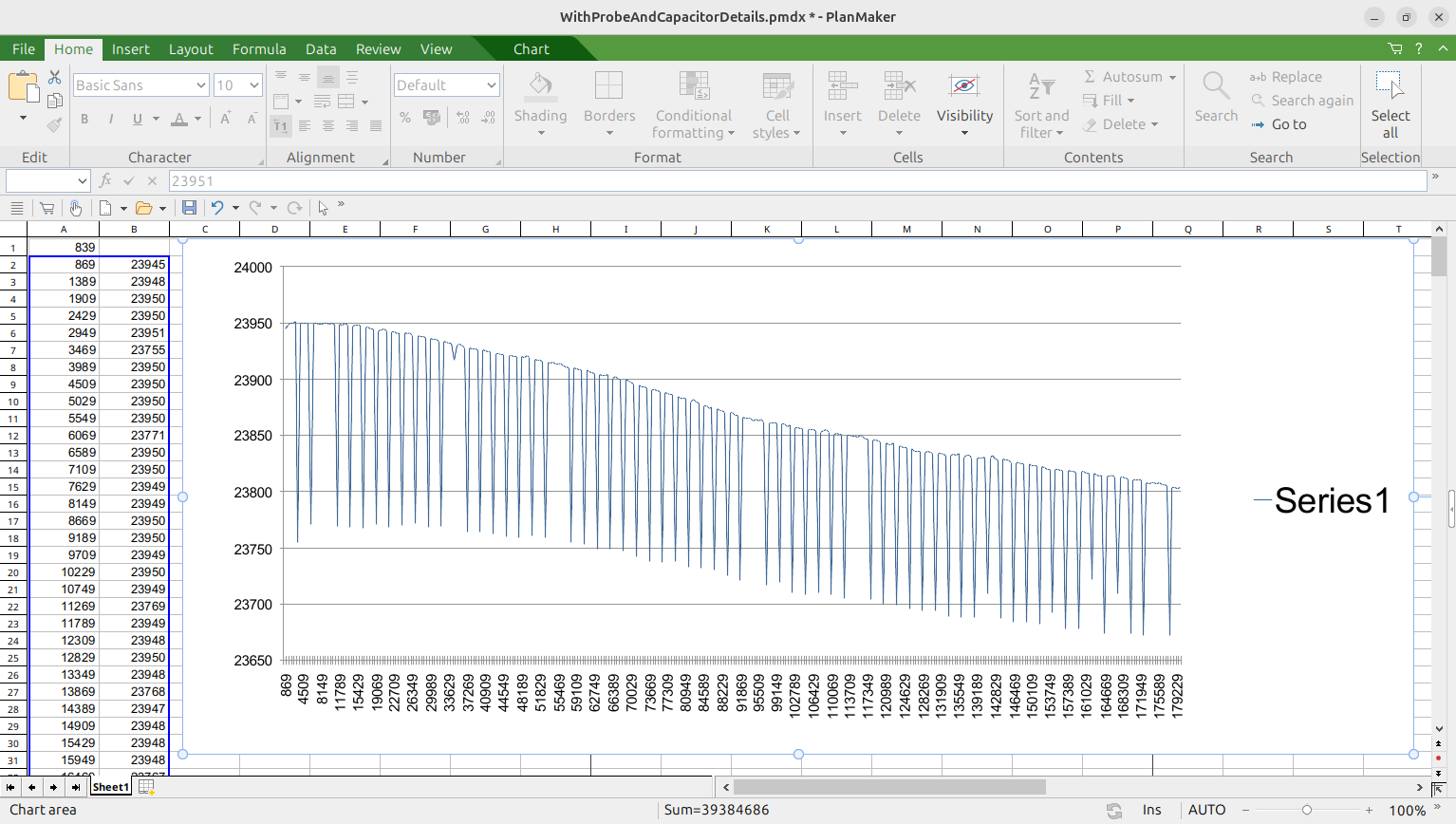

I have a few probes (one of a different make) and they all seem to slowly reduce resistance when measured so assume this is just a "feature" of them which we need to work around. So that leaves 2 issues.
1. the random spikes. Wonder if moving to a soldered board may resolve that?
2. the time it takes to start giving good readings. This I no suggestions for :)
When you say the capacitor may not be needed, do you mean the one on the power supply? I seem to recall the spec saying I needed that to cater for the spike in current needed when it was processing. The one on the ADC pin seems to remove a lot of the noise we saw?
Out of interest I drew a graph of the individual values from the test with the probe and the capacitor (i.e. every reading rather than the averaged ones before) and that seems to suggest I am getting highly fluctuating results which the averaging is masking.
Screenshot from 2025-02-08 18-43-44.png (198.68 KiB) Viewed 1550 times

Yes, the ADS module already has the required capacitor(s) on the supply voltage side the of the ADS1115; so one of the capacitors (the top one) in your diagram is not needed.

I rewired the whole thing to remove the pull up resistor, the capacitor across the power supply and also simplify the layout to keep things away from each other. I have run a load of tests with varying results - some fairly stable and some all over the place. At the moment, I have a stable environment with a repeatable problem. As mentioned before, I take 5 readings each time and then output the average. Looking at the details though the first read is wrong but the other 4 are broadly the same (within 2 ADC values). E.g. 23721, 23884, 23885, 23884.

The other odd thing is that if I power it from the USB port of my laptop it is stable but if I power it from my phone charger it is unstable again. Adding the capacitor across the power supply seems to help although still not as good as using the laptop. Also taking it out of the phone charger and straight into the laptop the laptop reads around 8 ADC higher!!

leenowell wrote:
Sun Feb 09, 2025 2:15 pm
Yeah, good power supply is important. After all, we're operating at the micro-Volt range of analog signals here.
If noise from the (switch-mode) power supply is an issue, one or more capacitors between Vcc and GND can indeed help. In this case, it may be best to filter power at the 5V side (pre-LDO), e.g. with something like 100nf+1uF+10uF in parallel.

The board is a dev board powered via USB so assume I would need to put the 3 capacitors on the 3.3v supply from the board to the ADC? I did some further testing last night and it ranged from very good (+- 1 with no spikes) to being all over the place. I am wondering if it is the breadboard causing half the problems so was thinking of soldering the circuit onto a board to see if that helps?

leenowell wrote:
Mon Feb 10, 2025 9:15 am
Should work too. (You can also filter the 5V (USB) supply of the dev board at the board's 5V pin.)
Thinking about it, filtering the 3.3V between ESP and ADC may actually be better since this may also reduce more of the noise caused by the ESP itself.
Certainly worth trying.
