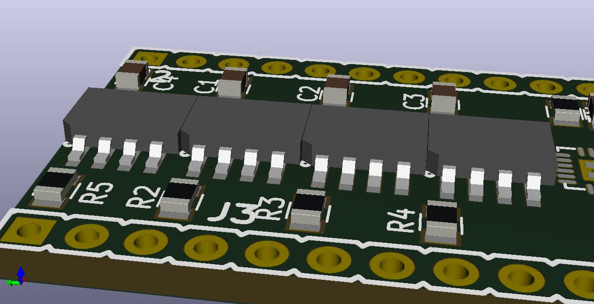

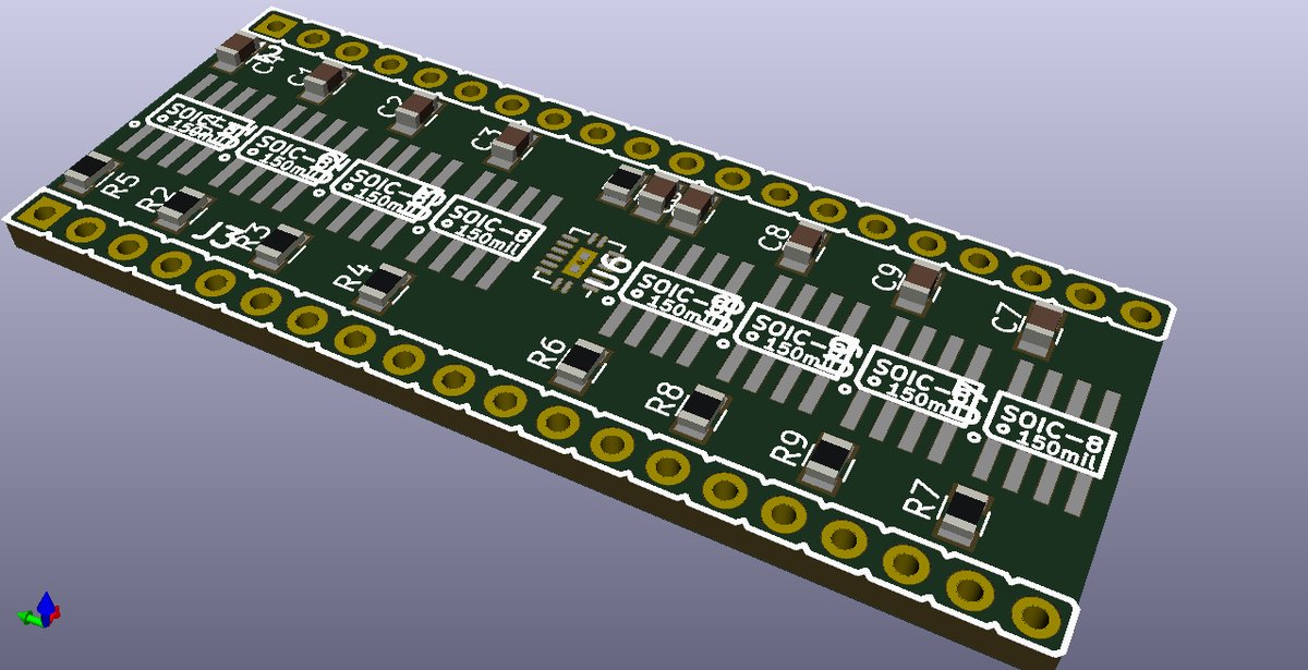

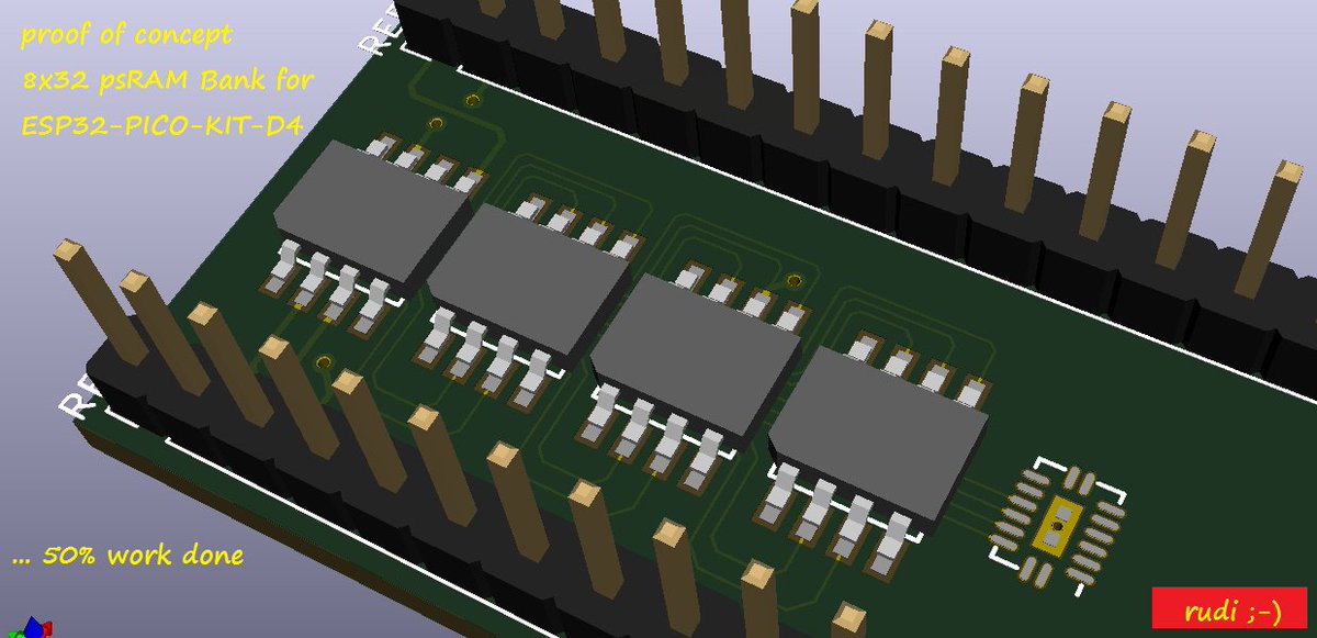

btw
there was a psram switch bank work on Pico D4 too
perhabs this helps you to configure it out.
