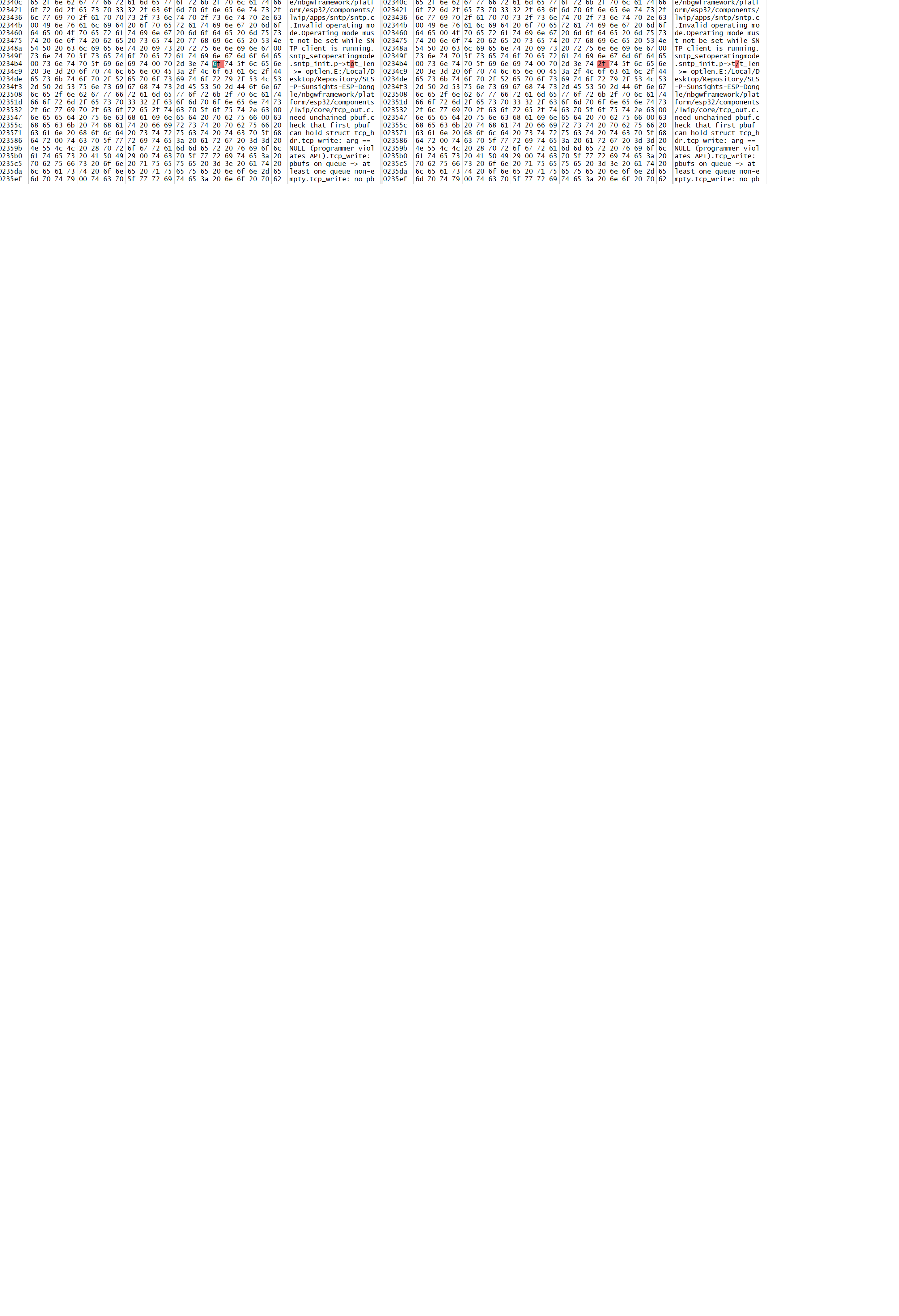

We have checked again Firmware File and Firmware Contents stored into Flash location and found that one bit is corrupted in between due to which overall checksum is failed.
But, We don't have any idea like how bit is going to change of firmware stored into flash location?
Anyone has idea like Flash Memory lot is not proper or kind of any other guess?

Where is this bit located and how did it get corrupted (as in: what is supposed to be there and what did you read there)?

ESP_Sprite wrote:
Thu Nov 03, 2022 12:52 am
Hello ESP_Sprite,
We have checked and compared each and every byte of stored firmware and firmware file which we have flashed in which we have found at one location where one single bit has been changed from 1 to 0
Please find attachment for the same
We don't know that how it is has been changed on site which we have to find out.
Bit Difference.png (148.72 KiB) Viewed 8131 times

We have received following updates from Espressif Sales Team regarding issue which may be solution for us.
Dear Ritesh,
Thanks for your information.
For the issue you encountered, we speculate that in the process of frequent power-on and power-off, the flash may be under abnormal working voltage for a long time and disturbed by the power supply jitter, disordered instructions on the data line may cause the flash to operate incorrectly, which caused the bit transition.
This issue has been fixed on esp-idf master branch, and the fix commit is 6a2d3509dcedc2fe67a98ae3a0fd5a089c256ef8.
https://github.com/espressif/esp-idf/co ... 089c256ef8
The fix uses the built-in brownout detector to monitor the external power supply voltage, it will send a command to stop the flash operation in time to avoid flash misoperation when a power failure is detected. It is recommended to test and verify after applying the fix.
From the log output of your device, I find that esp-idf version you are using is v3.1-beta1-216-gd91c425178-dirty, please note that v3.1 is already EOL.
Please see ESP-IDF Support Period Policy.
https://github.com/espressif/esp-idf/bl ... _POLICY.md
I have checked with our internal team, we may not backport this fix to esp-idf v3.1, will you upgrade the IDF version to the master branch? It would be a big challenge for you cause there are many changes between v3.1 and the master branch.
But, We don't have any option to port our application over Master Branch as Product is already deployed over site and we have only OTA support and also lot more testing and porting time is required to move into Master Branch.
So, We need to find out particular patch or changes into current IDF 3.1 in which issue can be resolved.

The mail actually refers to the commit which changes the behaviour. You can backport that to your ESP-IDF version.

ESP_Sprite wrote:
Fri Nov 04, 2022 6:34 am
Hello ESP_Sprite,
I have checked changes from top and it seems like difficult to back port those changes into ESP32 IDF Version which we are using. Because those changes are made over ESP32 IDF Version 5.0 while we are using ESP32 IDF Version 3.1 as per our application requirements at that time.
If you have any suggestions or clue like how it can be back ported those changes into ESP32 IDF version which we are using and that would be really appriciated.
