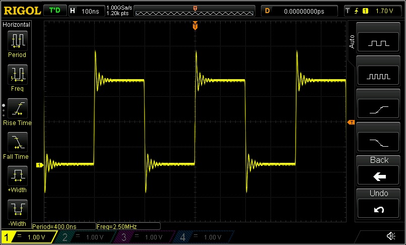

Postby rudi ;-) » Tue Feb 28, 2017 9:29 pm
my setup test was from 2.5 MHz do 154 MHz
each higher pos was more clear as the preview
example 2.5 MHz ( Jitter )
rtc_plla_ena(1, 0, 255, 0, 0); // 2.5MHz
info for the choice of src of clock and register are in the technical docu too
hope this helps.

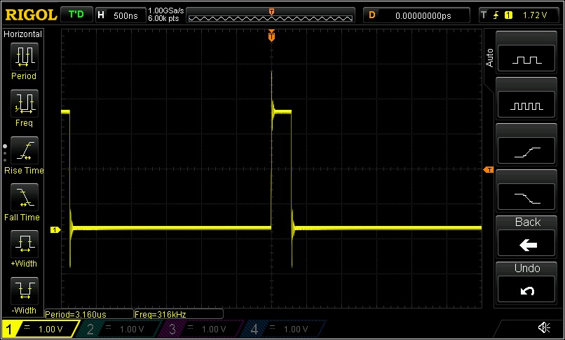

Posts: 1734
Re: ESP32 Webradio

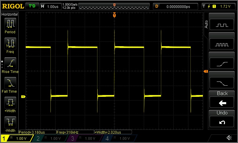

Postby rudi ;-) » Tue Feb 28, 2017 10:31 pm
yeap, WiFive is right.
316 kHz
you must play with the clk register itself too
and we must use the right src
there are many parameters possible, better we wait for the docu
we can stretch time too ( ? ! )
we can polarisation too ( ? ! )
we can invert too ( ? ! )
we can do more ( ? ! )
i think "my" setup was the best for 10MHz ..160 MHz
if we want smaller we need a fine tuning with other src by choice the right register.

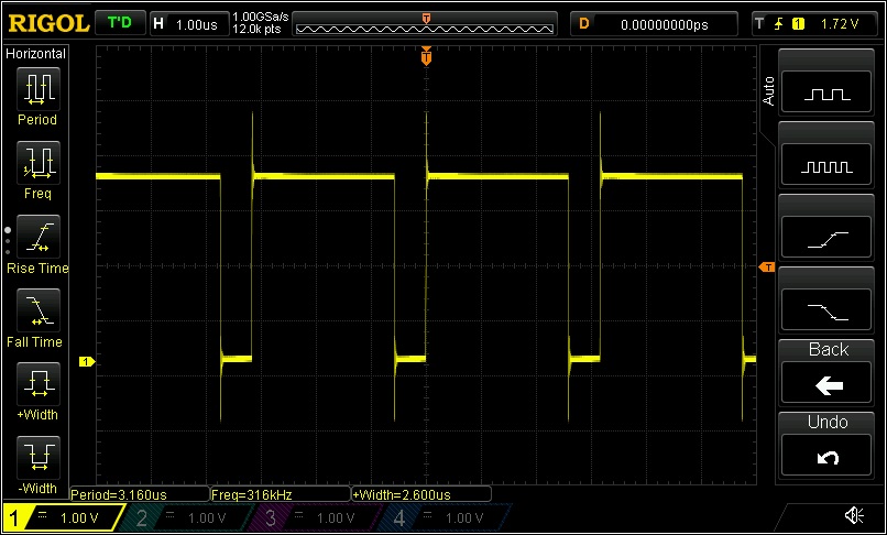

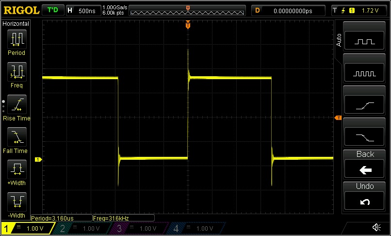

Posts: 1734
Re: ESP32 Webradio
Postby rudi ;-) » Tue Feb 28, 2017 10:50 pm
played with the stretching and polarisation
same 316KHz
but :
5_10
6_10
8_10
with more playtime the jitter can be compensated
and there are differences with
-> DevKitC V1
-> DevKitC V2
-> DemoBoard V2
-> Wrover V1
-> Wrover V2
i mean, the jitter make sig time delayed waved, perhabs a caps to much in the line?
.. i do not know .. i am
hardware hobbiest
:mrgreen:

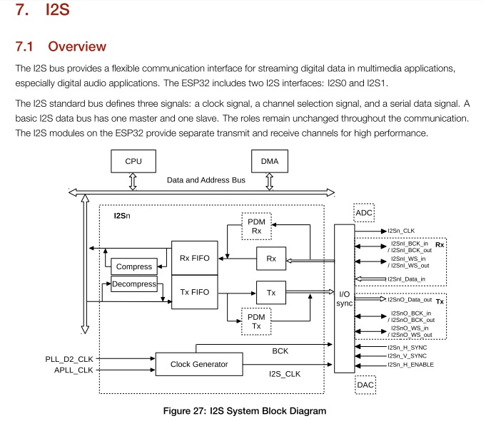

Hi Rudi
I did change the plla_ena in the i2s code as well. It is the jitter that we need to reduce. For audio codec and i2s interface with out faster MCKL in the setup, the jitter on BCK crank up the noise floor in the audio band.
We need more insight to the esp32 clock system to get the apll going - the audio quality is good for now - just no CD quality yet.
Do not down play you hobby approach to this stuff - you got you hand more dirty then most professional has the skills to do.
I am stocked by work and lag of focus - I am working some dsp stuff that also will be needed to do a top notch platform.

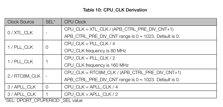

Posts: 1734
Re: ESP32 Webradio
Postby rudi ;-) » Wed Mar 01, 2017 10:04 am
@Jakobsen
thank you for the friendly words.

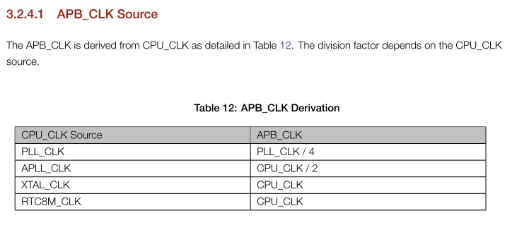

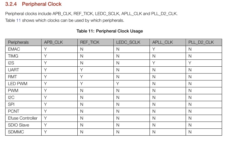

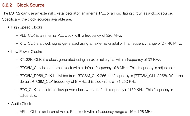

have you seen, we have now I2S Theme in ESP32 technical Reference
Update is from today, 2017 March 1
V 1.5
here you get it
visit allways the espressif resource for newer updates
