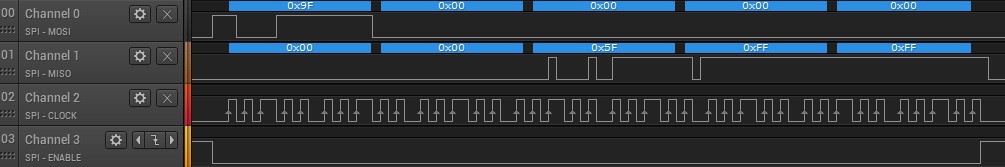

Postby rudi ;-) » Thu May 18, 2017 10:45 pm

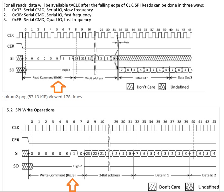

ESP_Sprite wrote:No proper datasheet yet... coming pretty soon though. It's RAM, so if any, you do not have pages as such, and you do not need to erase them; you can just write different data over them. I think I can copy/paste some data here: be warned that's not from a released or finished datasheet yet, so I don't guarantee these figures are correct.
hi Jeroen,
just in time tested CMD READ_ID and CLK out 4 times 0x00 for a test
cause not sure how long is ID.
Can it be ID is only 1 Byte 0x5F ( 1b1011111 )
how looks this to you for READ_ID
for the first try on READ_ID
edit:
Read ID change at each start
btw it looks like a small typo:
From the Table
SPI write command option must be 0x02 right ?
until the chapter appears in technical reference,
we continue to play a little bit in the meantime.
