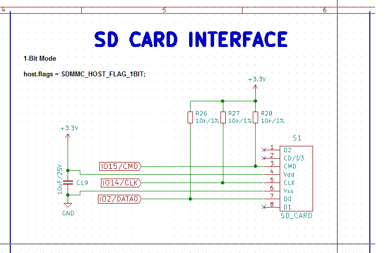

I just tried SDIO example (https://github.com/espressif/esp-idf/tr ... ge/sd_card).
1bit mode works, but 4bit mode does not work.
Connections are ok (correctly as https://github.com/espressif/esp-idf/tr ... d#hardware).
My SD card board has no internal pullup register.
I've already done `espefuse.py set_flash_voltage 3.3V` .
error log is below(verbose log).

Do you have pullup resistors on SD card data lines? Sorry, I don't understand what 'internal pullup registers' means.
looks the connection like the second?
You must itself pullup the lines!
pullup the GPIO with Software does not work
You need "hardware resistors on the lines"
only for clarification:
does the 1bit mode that works -look like this?
do you have Pullups in Hardware in the line?
so you must do the same in 4bit mode with the other lines like posted and named in the demo.
@ESP_igrr "Internal" means "inside" or "on board". My sd card board has no pull up resister by itself.
@rudi
Yes. I done hardware pullup the line. not software.
All 6 line is pulled up by 10K ohm register.
And, I am doing this on breadboard. Is it OK ? ( I heared that breadboard is not good for high frequency circuit).
What else should I check ?
What else could be considered as a reason for crc error ?

In case you are doing this on the breadboard, re-check your connections. The error being reported is 0x109 or ESP_ERR_INVALID_CRC (see esp_err.h), which usually indicates that there is a signal integrity issue. The driver will use 20MHz clock for most of the cards.
If you find that this doesn't work reliably on the breadboard, you can lower the frequency by changing the value of max_freq_khz field in sdmmc_host_t structure passed into sdmmc_card_init function (like this).
