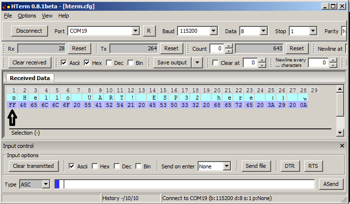

( FYI )
on 115200 -is ur uart bitbang?- there is the first byte 0xFF then comes data
on 9600 the data are fine, but i will check all again
