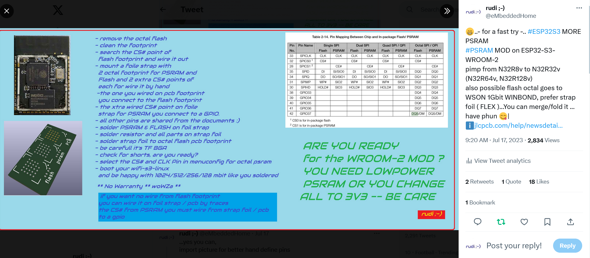

- ( if you can't use twitter )
- Screenshot 2023-08-01 at 21-37-27 rudi -) on Twitter.png (1.03 MiB) Viewed 22293 times
