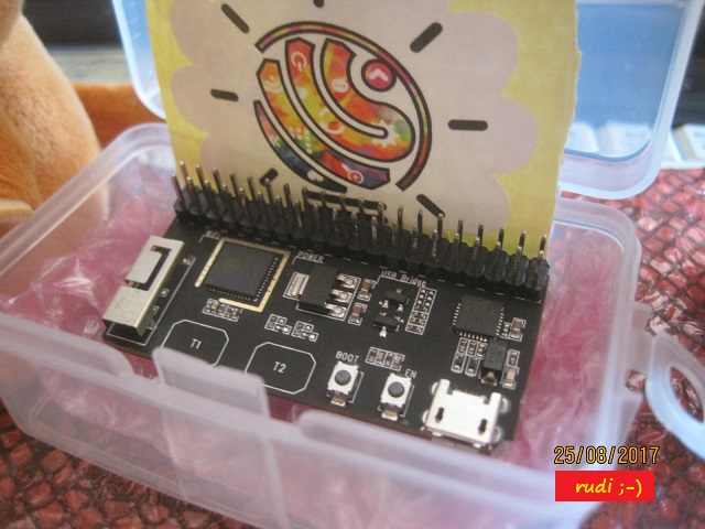

this was gone fast - now just arrived on my desktop 8-)
and now will take time for a round of play with it.

first test with ESP32_PICO_Core_Board_V2 for define the done VDD_SDIO intern
and later must use supply pSRAM connect from extern ( 1.8 or 3.3 )
so the "eMbeddedFlash" ( packaged flash ) in PICO-D4 is a 3.3V "packaged" Flash right?
@ESP_igrr ( i remember in D2WD was it done as "eMbedded" into SoC by 1.8 right? )
next steps i will test pSRAM to connect
i have here 1.2V wide (1.2-1.7) , 1.8V, 3.3V
in size of 32Mbit, 64Mbit, 128Mbit and 256Mbit
all in SOP-8
8-)
knowings:
D2WD has 16MBit eMbedded Flash in SoC
further results:
where
PICO-D4 has 32MBit packaged Flash on SoC from 'GD' and it is 3.3V
right?
i will test then 3.3V pSRAM next time then.
can test then 1.8V too cause Flash itself is 3.3V so this damage not the flash over the dataline if i use 1.8.
