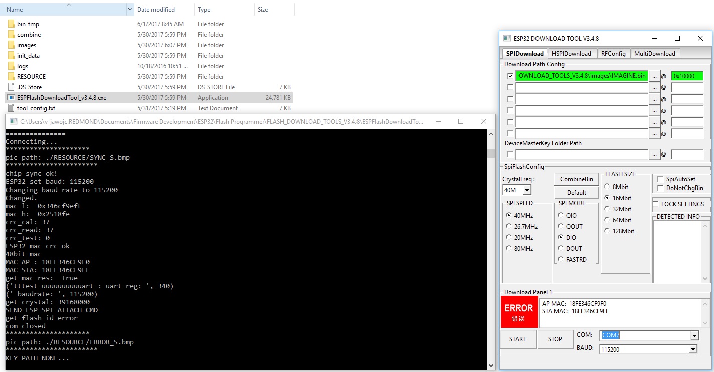

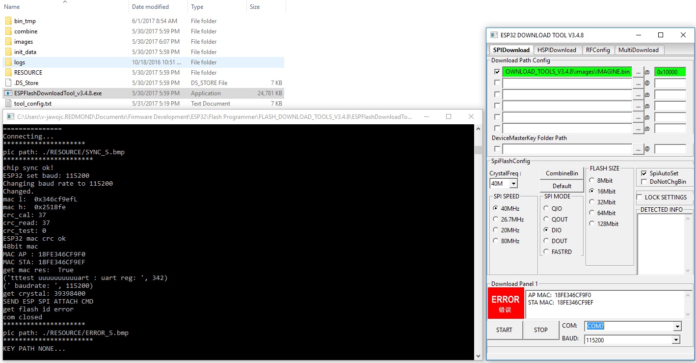

Thanks for your responses. I'm wondering if the internal 1.8V regulator has enough current for the internal flash? I have a 1.8V switching regulator on my board that I can solder to the VDD_SDIO. Other than that, I'm thinking that it is a software issue with the Windows download tool since I can successfully communicate with the ESP32 every single time and it show the MAC addresses. I have tried several circuit boards and they all do the exact same thing. Any other ideas?
Espressif engineering support states that the correct settings for the ESP32-D2WD are: Crystal: 40M; SPI SPEED: 40M; SPI MODE: DIO; FLASH SIZE: 16Mbit
I have also tried the SPIAutoSet mode but that did not work either.

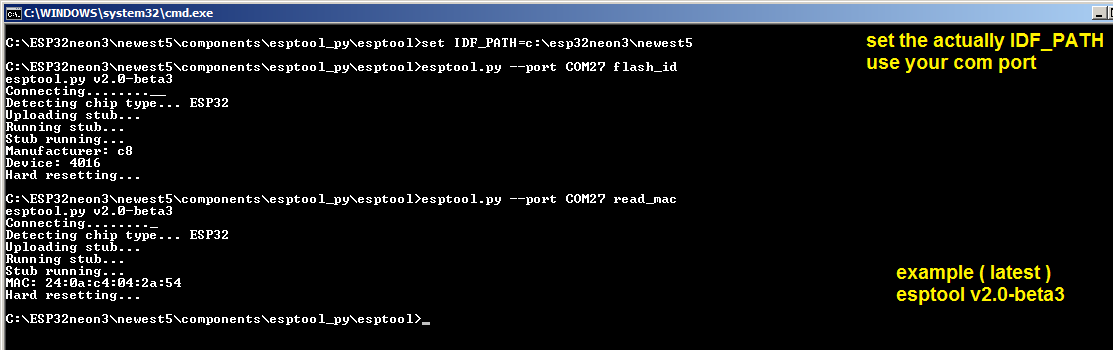

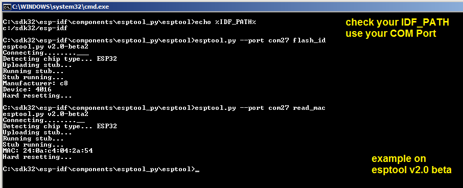

Re: VDD_SDIO for ESP32 D2WD
@jamie
here a test on an ESP32-D0WD
with esptool v2.0-beta2
with esptool v2.0-beta3 ( the latest )
test it with your D2
and be sure, you pulled up the MTDI for VDD_SDIO 1.8V !
Am already very excited what comes out.
Please post it
rudi
Please post it
rudi

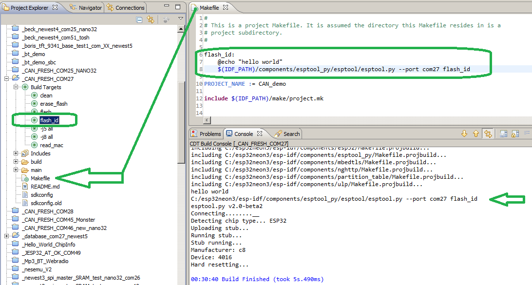

@jamie
and last but not least, if you not familary with esptool on console
and if you use example eclipse,
- make a new target entry with "flash_id"
- edit the project makefile and make a new target
write the commands in new line and use one tab ( not space )
( example on D0 )
rudi
now we wait your response
( example on D0 )
rudi
the hardware is now in my hands too (i'm the software guy, and jamie the hardware guy).
So the flash_id in eclipse gave me
and for the instant flashing from eclipse (windows) fail too.
10:00:58 **** Build of configuration Default for project Imagine Bracelet ****
make flash_id
hello word
esptool.py v2.0-beta1
Connecting.....
Detecting chip type... ESP32
Uploading stub...
Running stub...
Stub running...
Manufacturer: ff
Device: ffff
Hard resetting...
10:01:01 Build Finished (took 3s.317ms)

Attaching SPI flash...
Configuring flash size...
Warning: Could not auto-detect Flash size (FlashID=0xffffff, SizeID=0xff), defaulting to 4MB
Flash params set to 0x0220
Compressed 9488 bytes to 5745...
A fatal error occurred: Timed out waiting for packet content

@ivan @jeroen @angus
do we need a special bootstrap pin( ESP-D2WD ) for "flashing" the eMbeddedFlash and later then for "booting" from it?
rudi
https://github.com/espressif/esptool/issues/205
rudi
