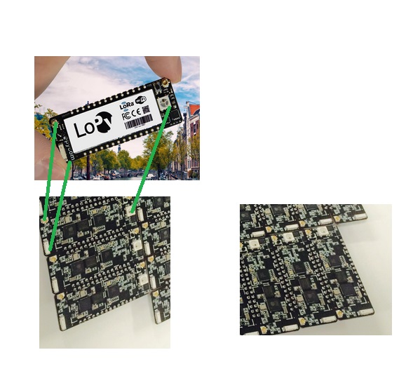

WiFive wrote:A herd of chips in the wild! I can't tell if these are 31b or 32.
http://imgur.com/QFzJj2B
Meanwhile, some sad beta testers are still without a sample. Still sort of encouraging. Must not jump ship to another chipset. Be strong.
haha ..
:mrgreen:
the nacked pcb it look like the same you posted as crowdfunding
( but such a coincidence also. :mrgreen: )

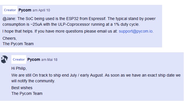

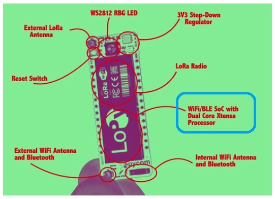

btw: PCB:
e.g.
The combined antenna design for Bluetooth and Wifi is thus freely accessible including BOM?
The 29 finished Lopy have no final ESP32?
The 12 beta testers do not anything with Bluetooth?
Since then apparently escaped me something ...
and my knowledge of the Beta Testa me then handed wrong? ..
sorry
holidays comes next week - so perhabs this is a good time for change.
btw:
here runs a fully CAN Master / Slave as Software Solution on ESP31!
Modbus Master / Slave is done too. without Docu and Info
same theme like ESP8266 I2C Slave,
and a little more on RF theme with DMA..
