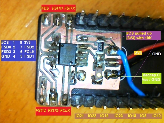

Hi rudy,
The code looks like it is supporting PSRAM for the PICO KIT, as far as I can tell. The code changed a lot since they initially added support for PSRAM, now the pin assignments are read from the eFuse, except the one for PSRAM CS, which can be configured via 'idf.py menuconfig'.
I did open an issue on Github to describe my attempts to use PSRAM, see https://github.com/espressif/esp-idf/issues/6350
Unfortunately not too much progress, although I tried lost of things (see the issue).
It seems to be able to access the PSRAM, but the memory test fails with some kind of repeating patterns.
Maybe you can take a look at the issue and let me know if there is anything that catches your eyes. I am quite sure that I am doing something wrong, but what ?
What really wonders me is that CLK line (FCLK - IO6) only goes up to about 1.8 volts, where all the other signals go up to 3.3 volts, as I would expect. From the strapping pins, especially IO12/MTDI, it correctly sets the voltage to 3.3V. I wonder if this is causing the memory test errors, due to skipped clock pulses? I also tried to use a different pin for PSRAM CLK, but this shows the exact same effect, and the same memory test errors.
Kind regards,
Ingo

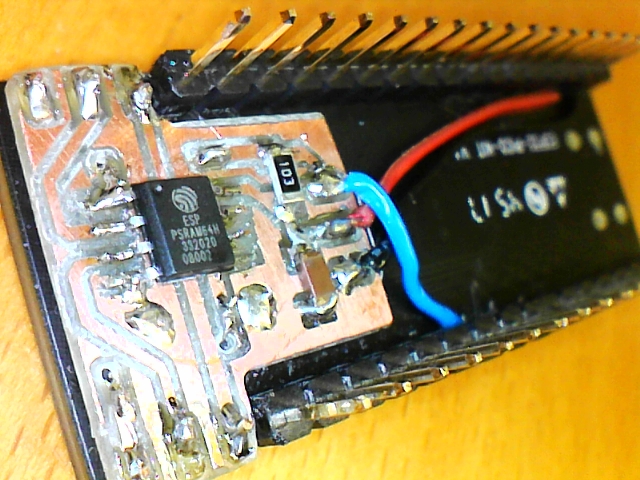

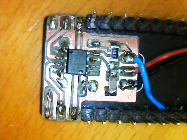

FYI, this is how I mounted the PSRAM to the PICO Kit:
Re: Small ESP32 Modul ( all include in new ESP32-PICO )
@ifranzki
Ingo, i read from your pics this wireing, can you check, did you like the comments on your pic?
Can you read from your PICO Chip which (production) time stamp the Chip itself has
likewise 382017 or from XX2018 or 052019 or higher
Kit 4.1 has minimum knowed 2 different Version ( silkscreen change and differ )
edit 1: btw nice "T-Mount PSRAM" PCB
edit 2: FYI silicon bug REV 0 / REV 1 in ESP32

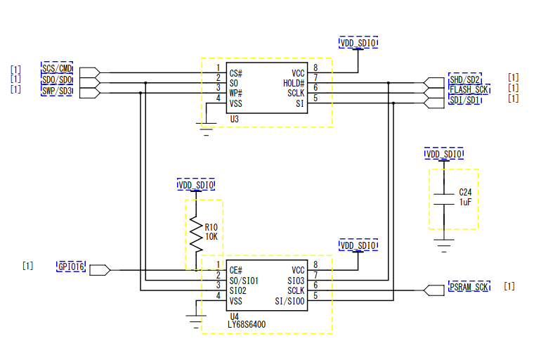

edit 3: FYI cause why not shared CLK pins with Flash CLK
See at this shematic - flash and psram have own clk pins ..
used shematic with not share the clk in design at this time where psram was started was confirmed at this time from an espressifer for NOT share the CLK pins and looks good -
the confuse was - the CLK share was in Espressif's "Datasheet's at this time" done ( shared clocks ) -
WHAM
"Sentences like 'GPIO17 and GPIO16 are used as CS and CLK' are only meant to illustrate that these two pins are in use, they are not meant to derive a pinout from (we'd use 'respectively' in that case to indicate there's an 1-to-1 match.)
"only illustrate" = symbolic character
the reason was -
nobody did know from us "hobbiest" here, that the silicon Rev 0 did have a CLK share problem ( more as 40 MHz ) ( not the PSRAM CHIP ) ( silicon bug in REV 0 )
espressifer's did not write here about this at this time
it was point out step by step in the psram thread i did start to point out the magic.. step by step ( salami tactic ) you got infos confirmed after you found out magic steps.. the right pins setups after you found out there are no info about ..last but not least manufacturer check of psram ...after you found it you got the confirm you have to know the psram theme was pure emotional theme and it is today the same emotional theme like it was in the past - now we have a share in the CLK's for PSRAM and Flash..

Hi rudi,
I did try to use a separate CLK line for PSRAM (IO9 - see my last comment in the issue: https://github.com/espressif/esp-idf/is ... -761839678), but this did not make a difference at all.

Yes the comments on the pic are correct, and they match the wiring on your schematic, except the shared CLK line.Ingo, i read from your pics this wiring, can you check, did you like the comments on your pic?
It is 382017. I do have another PICK Kit board, it has 362018, but I did not yet try to mount the PSRAM there. Do you thik its worth giving that a try?Can you read from your PICO Chip which (production) time stamp the Chip itself has
Hi Ingo
could you solve it in the meantime?
i was longer not reading this post, too busy too..
btw Ingo:
you can try SOFT-USB-OTG on the Pico D4 - it work's like a charme!
you can flash it over this too, need a little soft reverse change then, but for flashing enough - and no need for the CP2x.. or anything converter , anyway, soft-usb-host work's nice on a ESP32-Pico-D4 here with PSRAM also PSRAMBANK
play-station , play shield , SOFT-USB-HUB for the ESP32-PICO-D4 and so on
TryIT - DoIT!
also make the "T-Mount-PSRAM™"
rudi
T-Mount-PSRAM™
credit: ifranzki
btw Ingo:
TryIT - DoIT!
rudi
T-Mount-PSRAM™
credit: ifranzki
