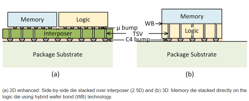

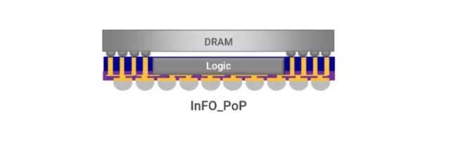

Re: ESP32-S3 LCD and I2S FULL documentation
@ESP_Sprite,
I believe that using a second sram die would also be a problem, but here's a suggestion.
As sram takes up more space on the die than psram(dynamic ram), the memory size could be reduced, 2MiB or 4MiB for example.
Direct connection to esp32-s3 address and data bus without cache (maybe a large data bus) with through-silicon via (TSV) and microbumps.
Obviously espressif have to consider the cost issue of this TSV technology.
