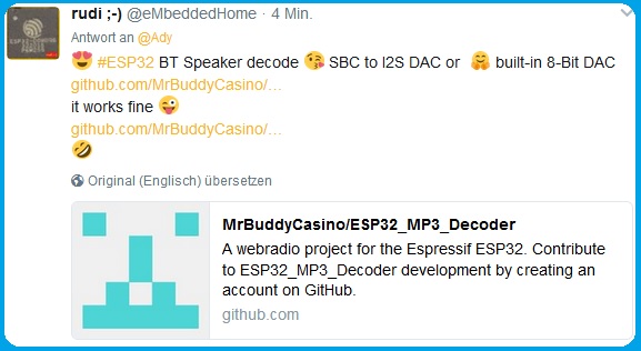

From the Tweet
Live Test with ESP Speaker Mode
and Android APP: Talking to A2DP - BabyPhone is born - done
direct demo show on YouTube
rudi
Music Stream by A2DP:
First Download and Config ESP32 Webradio to Bluetooth Speaker Mode in Menuconfig
- Boot then your ESP32 with Speaker or DAC or what you want
- Activate Bluetooth on your Android
- search the A2DP SINK ( ESP-Speaker )
- connect to the Sink
- play your music, video ( audio will be streamed )
Bonus: talk to esp32 by A2DP
- run the Free A2DP Talking APP
have phun ,
thanks to @BuddyCasino for the ESP32 Webradio and support BT Speaker Mode...
