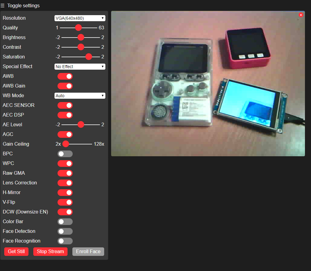

I just made a project that include a esp32 camera webcam (m5stack camera) and a reciever: m5stack or any other esp32 based device with LCD.
Here it is: https://github.com/botofancalin/ESP32_Camera_System.git
Is based on espressif camera library. I adapted the camera component to be used as a library on PlatformIO
The 2 projects from that repository: camera sender and camera revciever, can be compiled using PlatformIO.
You just need to adapt the camera data pins for your camera model.
The camera can be accessed from web browser too and can set various settings on it:

Yes. Even SVGA 800x600 if i lower the quality. (the higher number indicate the lower quality)
I think it can do even better with some tweaking... even if my camera module don't have PSRAM :)
I use JPEG format. The camera settings are the ones you can see on the image. I use OV2640 camera.
As browser, i tried Chrome, Firefox and Opera and it work just fine on all of them.
For some reason it don't work on Microsoft Edge browser...
What windows app are you talking about?
You can access the stream directly: 192.168.4.1:81/stream
Or you can get the independent frames by accessing 192.168.4.1/capture
