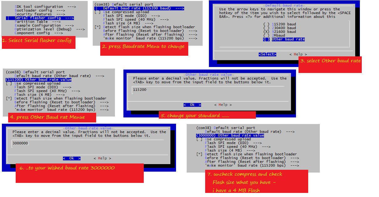

Postby rudi ;-) » Wed Jul 12, 2017 8:32 am
ESP_Sprite wrote:Also, rates near 1MBaud, like you use, are pretty finnicky to push through unbalanced, un-terminated lines. You may just be running into the limits of your hardware.
esp32 watterott - nano32 board support 3Mbit
with esptool.py (msys32 esptool_py and windows ) no problem to flash with 2Mbit and 3Mbit and a custom baudrate
( *nix cp driver have a problem over 2MB )
btw: esptool.py support 2Mbit and custom baudrate in menuconfig
but windows Flash_download_tool is only 1152000
x.jpg large.jpg (150.16 KiB) Viewed 21362 times
but can't select custom baudrate and more as 1152000 on windows flash tool
it is limited by the Software

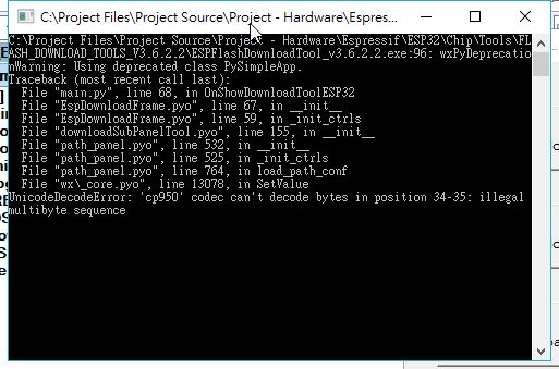

Postby colman » Mon Jan 08, 2018 9:30 am
V3.6.2.2 cannot run on my Windows, attached is the console error message.
